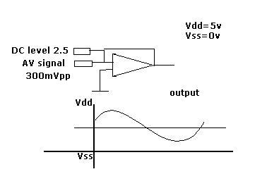

The signal that I want to read is an analog signal, like the 127 Volts ac, found in the wall outlets. but mi signal is a small signal with a frequency of 60 Hz but the amplitud is around 300mV
according on what you said me, thanks a lot, I should do the following
add mi ac signal to a DC signal so to say 2.5V in torder to the ac signal be between Vdd and Vss.
The figure represents the design and the output.
Thanks a lot guys.

clamp up
i think you have to ad a dc value to your ac input in such away your total signal swings symetrically between vss and vcc
