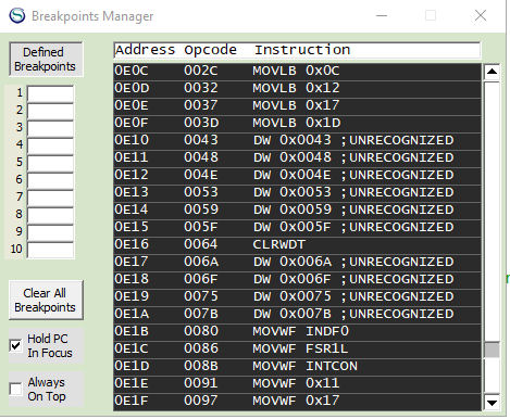

        org 0xe00
        ;note, dead band incorporated into table
        DW     0,0,0,0,0,5,11,16,22,27,33,39,44,50,55,61,67,72,78,83,89

You could use the code above the label notNeg to get the value to be multiplied by 56 and divided by 10.
Note, this will not make an allowance for the dead zone.
One thing to bear in mind, the DW table only uses half a K of flash. You still have 3.5K for the rest of your code. I assume the original code fitted in a smaller pic so this might be a viable alternative.
The original code was in a 12F629 so plenty of room in the 16F1827.
Only extra to add will to check if anything has changed since the last ADC read and skip it if nothings changed.
Hopefully this will be that last part of the puzzle.
Wrote quick test program to test code for display on LCD - doesn't work in Oshonsoft simulator (could be a problem of the simulator) - won't have time to test it in an actual PIC for a few days (shows 000 instead of table values).
Code below if anybody wants to mess around with it.

You may need to use different instructions to read the table?
eg.
Also, the table could be bytes rather than words, as you need every value a multiple of ten. That could save some program space, if it's tight?
eg. Divide all by ten so you have 0-250 range in single bytes, then multiply the result by ten.
Absolutely no point storing it as bytes as they're 14 bit flash words, so still 1 location per entry - I.E. same size.
The DW table is simply constructed from the excel sheet I did that calculates the value as requested.
The code was run (albeit in simulation) on the chip mentioned and referring to the datasheet for that chip. It works.
I suspect this was done as an attempt to simplify the code and not an actual requirement.
Edit, the values increase by ~5.6 per step, far from the 10 multiple.
When I sim that code... The LCD busy craps out too fast.. If the busy come on fast, it misses the second nibble read and the RW bit is never cleared...
I will work on it later as now I have a LCD written while busy error..
In the Oshonsoft Sim I set the LCD setup values to 1 to stop it messing up.
I think it's just the Oshon sim doesn't understand the DW instruction.
If you use the Breakpoints manager and look at the code, it either says 'unrecognised' against parts of the table or lines of gibberish in amongst the table:-
The MPlab listing file is fine without any of the above garbage.
As for size, it only takes a total of 521 bytes.

Further on the "Good news front", I finally managed to get some time on the workbench and tried Mike's table code (posts #24 & #28) in an actual PIC.
It works :D, thankyou Mike - I will actually use that in the project as it provides a better dead zone than the straight multiply/divide option I came up with.
I intended to ask (at some time) if you had tried it in an actual pic.
Glad to hear it's now all working.
Wonder why the Oshonsoft simulator didn't like it?
It works fine in the MPLAB (NOT X) simulator.
BTW, if you want the spreadsheet (along with the VBA that produces the DW table), so you can tweek values, let me know.
Thanks Mike, yes please, the spreadsheet would be welcome.
Re Oshonsoft sim, there are quite a few things it doesn't understand or can't decipher properly (like programs longer than 2048 words), really needs a massive overhaul to make it more useful.
