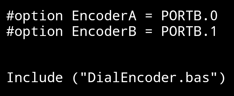

Which brings me straight in to encoders.......Does SF have an encoder lib? I cant find the part number at the moment, but i have a really odd encoder that isnt playing ball! Also i have never seen an encoder with 6 wires??

Looking at the program code, I found this:
Searching "Swordfish Basic Dialencoder.bas"
took me to the Swordfish module page. Sometimes you just need to know what you're trying to find.

For rotary encoders I normally use this,
        const char lookup_table[] = {0,-1,1,0,1,0,0,-1,-1,0,0,1,0,1,-1,0};
        DecState<<=2;
        if(DecA1)
            DecState+=2;
        if(DecA2)
            DecState++;
        DecState&=15;
        Pos+=lookup_table[DecState];
It uses the current and previous states of A and B (DecA1 and DecA2 above) to make a 4 bit number and uses that to index into the lookup table.

Thanks Mike thats handy! Also the 6 wires finally slowly (very slowly) dawned upon me and a sudden revelation took place, or in other words..........I stopped being thick and worked it out :D.
Edit, i have ordered a different encoder, he one that came feels a bit notchy, and not in a good way, BTW mike thats a real nice elegant way to do it, saves huge amounts of code compared to what i had in mind :D.
