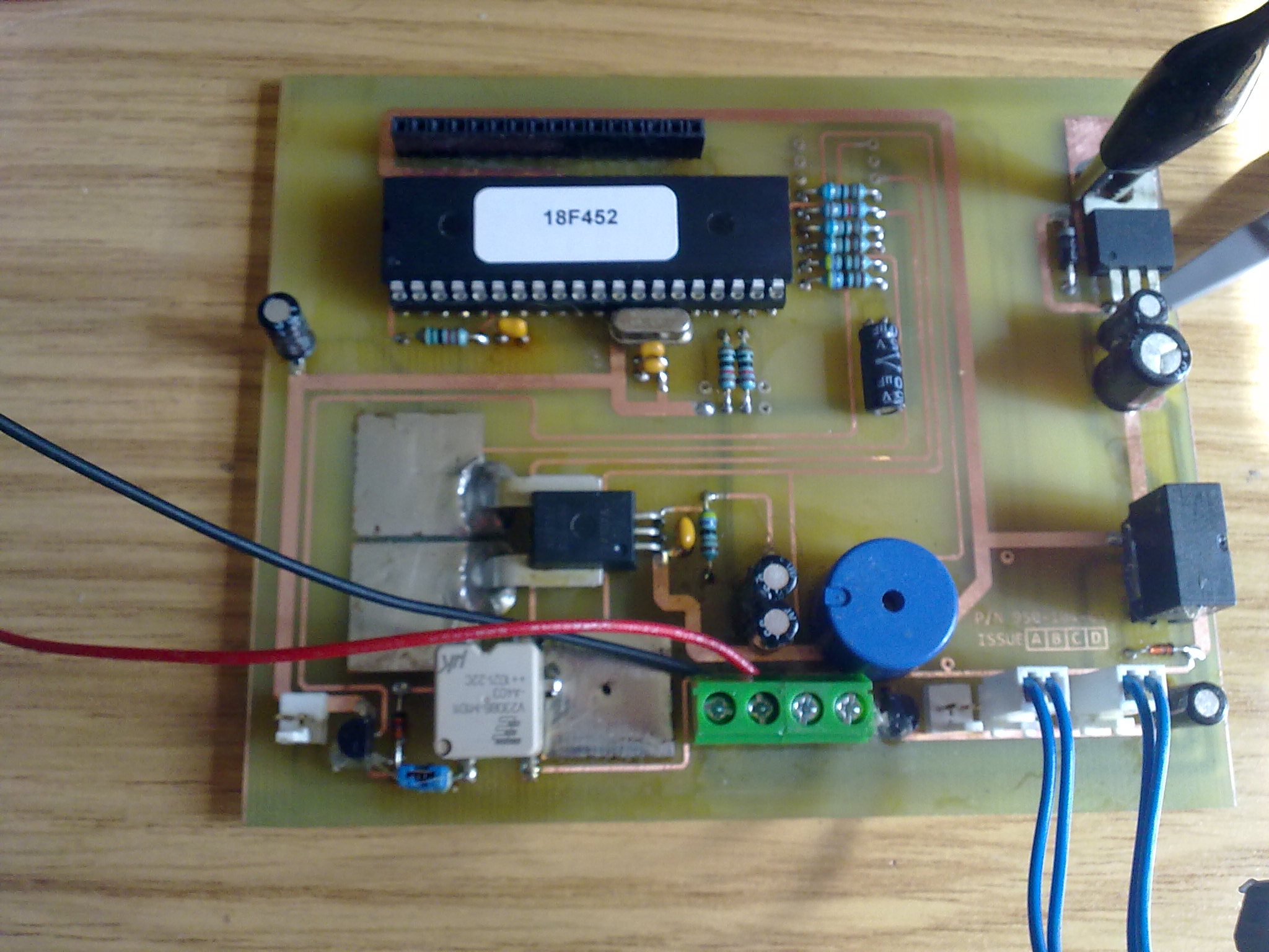

Find attached the PCB and the code and configs for the 18F4550. The PCB is clean!

Further to the above....
The set you set is with the LCD 20x4 removed and an 18F452 in situ. This setup works. The RA0 network resistors have been removed ready for replacement, but in or out work with the 18F452. The tactile switches are each connected to the 2off molex headers (blue wires) just out of view.
The decoupling for the PIC is underneath the PCB, 100nF within a few thou' of the +5V/0V. An additional SM tantalum is underneath the regulator also.
What if you disable the stack overflow reset ??? ...
May be your switch inputs act as glitches antennas ( see upper line ...) ... I'd use STRONG pullups or Pulldowns !!! ( Always when long PCB tracks )
also try to increase the debounce time for BUTTON ... some are really awful ...
Alain
