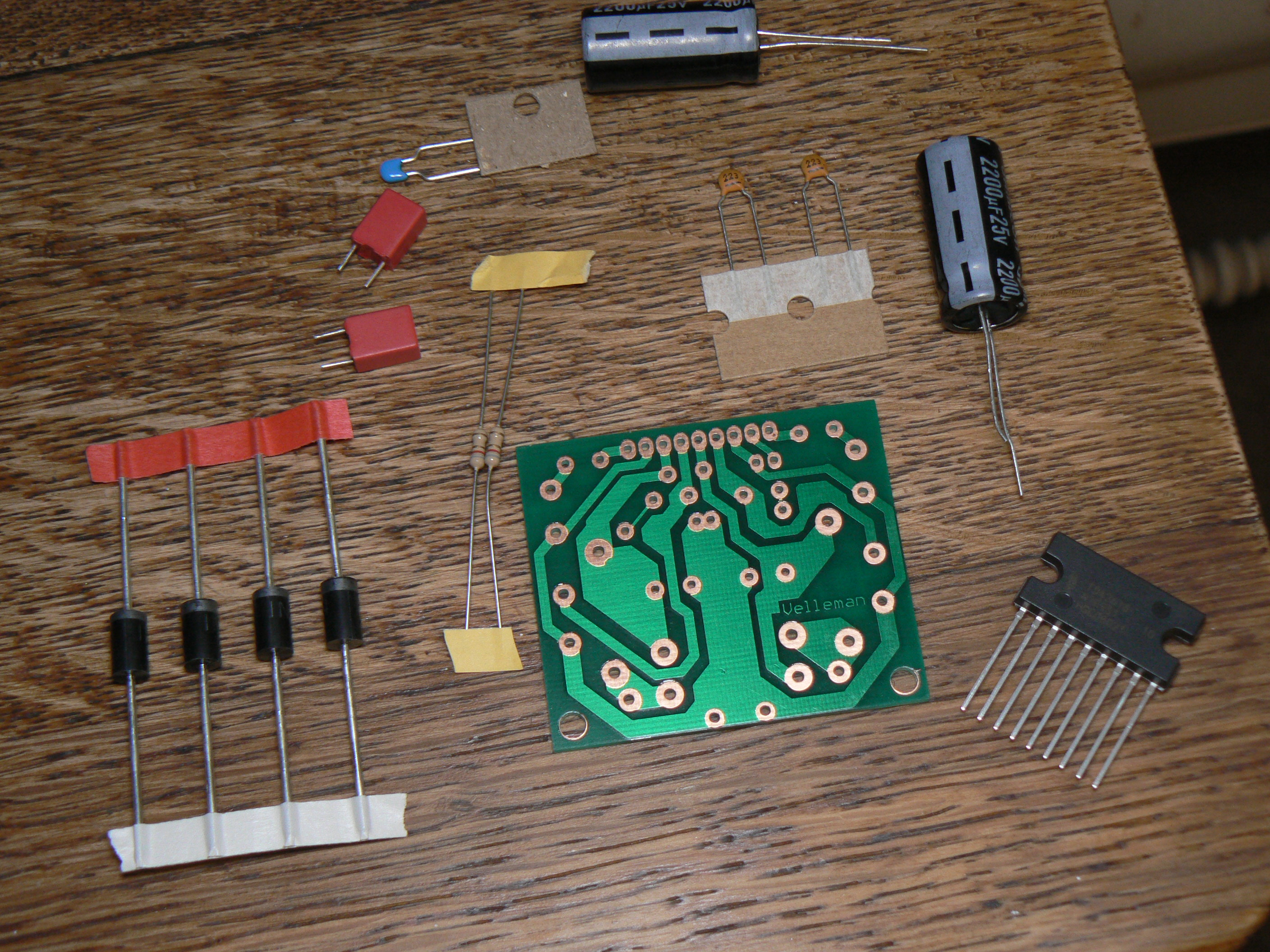

Hi, I've just got an amplifier kit from Velleman for an audio project of mine. On the outer box it failed to mention that it requires 12V AC, not 12V DC as I had presumed.
I wanted to run the thing from a 19V DC source. Is it simple to make a circuit to convert it to what's required? I'm pretty stuck otherwise.

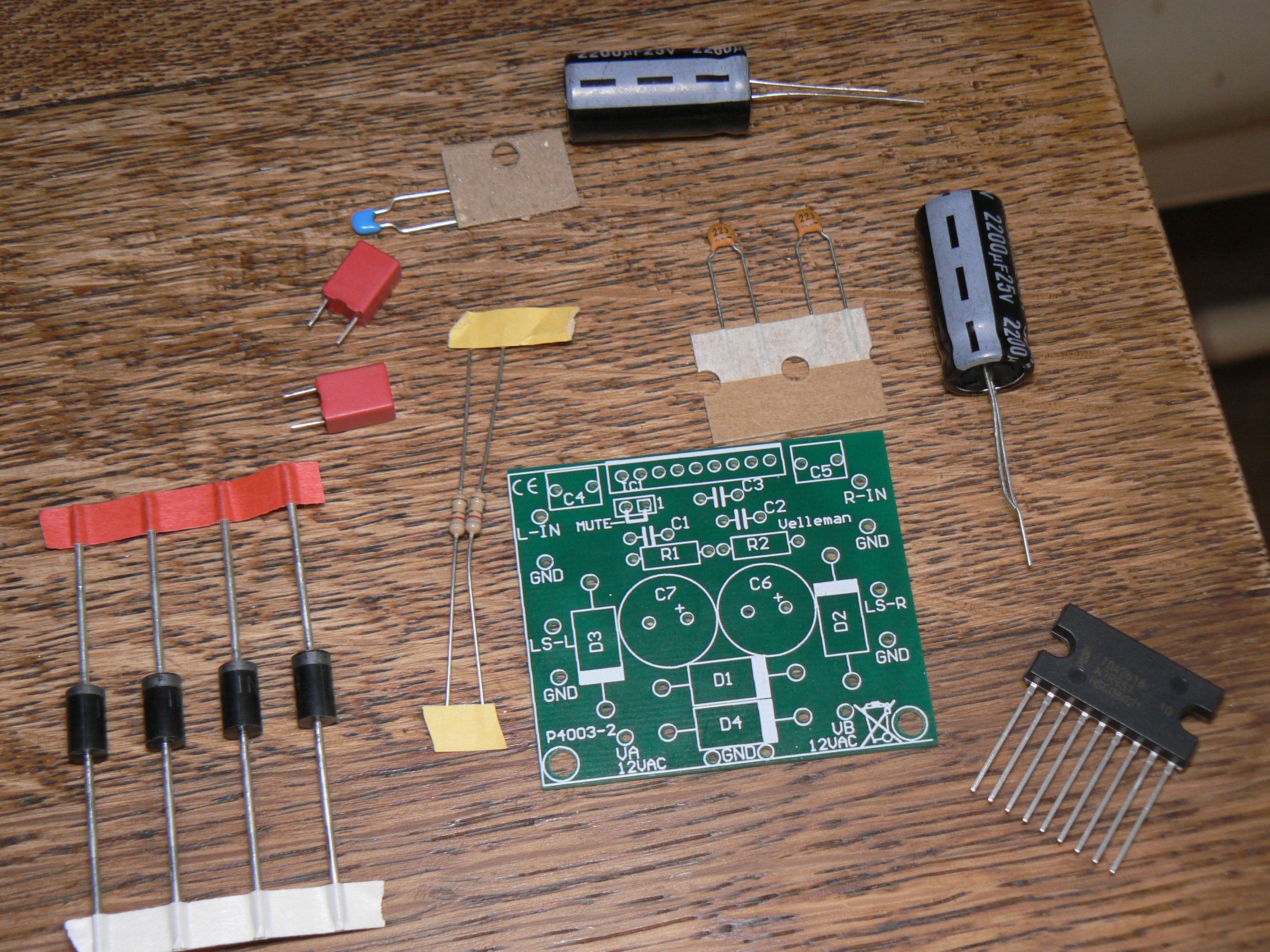

It looks to me like it can be bypassed, but I'm no expert! Do you think you could take a look at the images I've attached? It's a simple circuit, but I'm not very good at electronics so I don't really know what does what. I really hope it's possible to power it with DC!

Now it looks to me like they just take the 12 VAC and run it through a full wave bridge (D1, D2, D3 & D4) to get 12 VDC they pass along to the two caps as filters. If that is true you could get a LM7812 12 volt regulator and feed it the 19 VDC you have. The LM7812 regulator can be had at Radio Shack or just about anywhere. Now omit the diodes in the build and at the junctions of the diodes where two cathodes (band sides) and the two anodes (non band sides) tie together apply your 12 VDC output from your LM7812 with the common (NEG) going to where the anodes would have been tied and the + out of the regulator to where the cathode (band) junctions. That should work fine.

please check the download from here of the illustrated assembly amaual.
i feel the kit is K4003_rev1
it employes 12-0-12 transformer and thus dual voltages are needed
perhaps the cheapest is a salvaged transformer with 12-0-12 AC and 2 amps load capacity.
otherwise you need to make a dc to dc converter to the same spec. But direct use or regulated use of 19V to 12 V wont work.

If you look at page 8 and page 11 of http://www.vellemanusa.com/downloads/0/illustrated/illustrated_assembly_manual_k4003_rev1.pdf
You will see that you can run it from two 12 V batteries. You need a + and - supply.
You could use a voltage divider to give you the mid point of the 19 V, but that couldn't just be two resistors. It would need transistor buffers to give the current that you would need without excessive power consumption. Also the voltage would end up too low at +/- 9.5 V.
You could use an inverting buck/boost supply, like the second diagram on page 21 of **broken link removed** to give you -19 V or so from your present +19 V, and then run the circuit from +/- 19 V. If it is designed to run from 12 V ac, the peak is about 17 V anyhow, so 19 V shouldn't matter.

Uh Oh, and my bad earlier. Never saw the manual and caught the CT on the AC so it uses a split (+/-) supply. Also never saw the heat sink before. Yep, I would just buy a 24 VAC CT transformer (12-0-12) as suggested. Also since they call out 15 watts RMS I would look for a 2 amp transformer. Thanks Sarma for the link.

In the manual it says that an "additional rectifier and smoothing filter are unnecessary, as alternating current can be directly connected to the unit". Does this mean that it's not as simple as just connecting DC? Wouldn't I have to build a rectifier and smoothing filter?

No, my thought won't work. After seeing the diagram they are using 24 VAC center tapped for 12-0-12. I posted a my bad as to that idea. However, you can likely get a transformer from Radio Shack and use it to power the amp. Also I see where it is capable of 15 Watts RMS so you want about a 2 amp source. The Sarma posted was the big help.
Back to this won't be easy or practical from 19 VDC.
