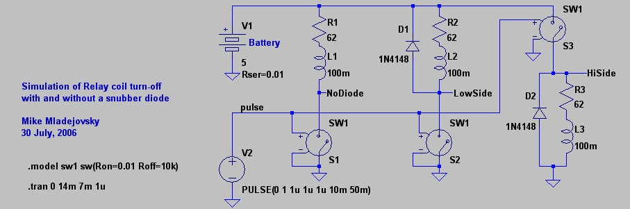

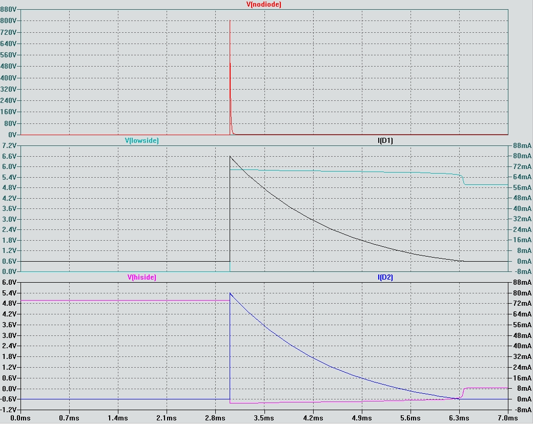

The current though an inductor cannot change instantaneously. The peak current that flows through the snubber diode is equal to the current that was flowing in the relay coil at the instant that the series switch opened.
Look at this simulation:
Recovery time is the primary diode parameter because the purpose of the diode is to protect the series switch from excessive counter-EMF. Counter EMF develops instantaneously (with fast rise-time) when the switch is opened, but the diode prevents it from reaching damaging levels to the extent it turns on quickly enough. The 1N4148 is a fast diode and therefore a good choice for the application.
The diode inverse voltage and forward current rating must be at least as great as the relay coil voltage and current.
