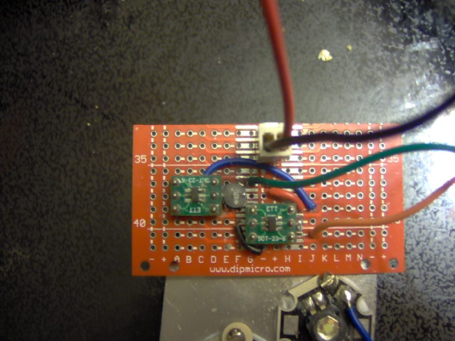

I have attached a picture of a ZXLD1350 buck led driver (internal switch), works great, get them parts close, and keep inductor away from the Rsense.

The Max1771 data sheet says that toroid, or pot style (see previous pic) inductors are preferred. Not sure what effects might be seen with the radial types. Inductors seem hard to track down. Here is a **broken link removed**.
The nfets need to have a really low gate threshold, if they are to operate from a 2-4.5V source. The IPU060N03LG is such an overrated part, it is hard to see the low Vgs characteristics Vs. I (drain) chart. A couple that I found from Digikey would be:
IRLML6244TRPBF
DMG3420U-7
Not sure how far you are going to get with all thru hole parts. Using adapter boards, for SOT-23 parts, like in the previous post above, is good for prototyping. Good luck.
