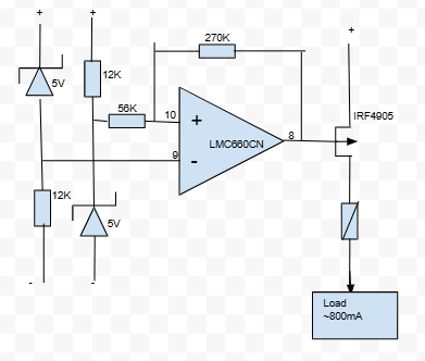

op amp to mosfet output destroyed
This may have been the casue of failure :
If the Inv input was taken below its supply rail,. with no current limit, would have fried
the input structure thru the forward biased Zener acting as a simple diode when v+ goes
more negative than a diode drop.....Fix would be a series R to Inv input, say 1K ohm from
junction 12K and zener anode.
Sorry, my V+ and V- are misleading. Should have written non_inverting < inverting, when the battery becomes full
the whole 'home' system with 20AH battery. This here with the 'lo_v disconnect' original version.

I didn't think I needed any as it essentially a dc thing with slow ~.5Hz 'pompings ' by the maintainer. Only ac fluctuation when it disrupts / re-establishs power and i didn't see any changes with decoupling of the amp supply
All electronic circuits require them, the entire premise of electronics is that the supply rails are at the same AC potential, and that's what the decoupling capacitors do - leaving them out will affect operation, and could cause potentially damage as well. It's not something you can just leave out.
I hope you understand that this configuration as a switch loses 3V from the supply and heats up the FET by switching V+ rather than switching from the drain to V- of the load.
3V? How are you calculating that? I see an 800mA load and 20mOhms of R(on), so only 16mV. Now you show yours.

FET 101 laws apply. Both Drain and Op Amp R2R to 12V. Click the switch then reply. https://tinyurl.com/2bnjqn6w
FET 101 laws? I'm not sure you need to go that far to fix your error.
It's possible you need to look at an earlier, more basic "Law". Like, "Reading Schematics 101 Law", or, "Garbage in, Garbage out" Law. Or, my favorite, "The person who yells loudest or has the flashiest graphics is rarely right" law.
Take another Peek at the OP's circuit. You may Pee yourself once you notice your error and aPologize for your Poor reading skills and/or incorrect assumPtions.
my bad
High side Nch FET drivers need a boost voltage to act as low dropout switches,.
That's why the OP didn't use a Nch Mosfet
Edit: I'm really amazed that this hint wasn't assumed to be a hint.
