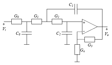

I am trying to build a 3rd order low pass filter. The design that im following uses 1 TL072. Since I could only find TL071 in my area i decided to use 2 of those to replace the dual opamp. My circuit is still not behaving properly though. When I'm doing this conversion am I missing something? The TL072 has no offset pins while the TL071 has 2 for each. I just connected these offsets to ground both on both chips. Am I doing something wrong there?
This is my first time building a filter on my own after college, so I'm trying to relearn some stuff. I am thinking that the cap and res tolerances when combined might be throwing my filter off.

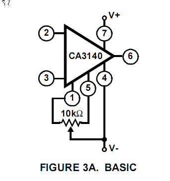

You dont connect the 'offset pins' to 0V.
If you dont need any offset correction, just leave them floating.:)
EDIT: the attached image shows the typical connection for a CA3140, for ref only.

Just ignore the offset pins entirely, there's no need to connect them to ground.
Two TL071's should replace a TL072 fine.

A 3rd order Butterworth Sallen and Key lowpass or highpass filter is made with a single opamp. It has the very low ouput impedance of an opamp.

Here is the circuit of a 3rd-order Sallen and Key Butterworth lowpass filter. The gain resistors are not needed then the opamp can be a simple follower if the RC values are different.

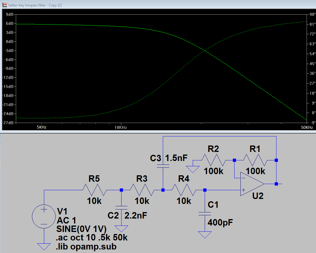

Could you tell me how to simulate this circuit ?
Any mathematical conditioning ?
Here is a simulation, use the ratios of its RC parts to change its frequency:

Thank you sir Audio guru and jpanhalt for nice theory and simulation.
I have been played with LT spice before, trying to put things in Multisim or circuit lab.
Let me read the theory well, then I will make pcb for test.
