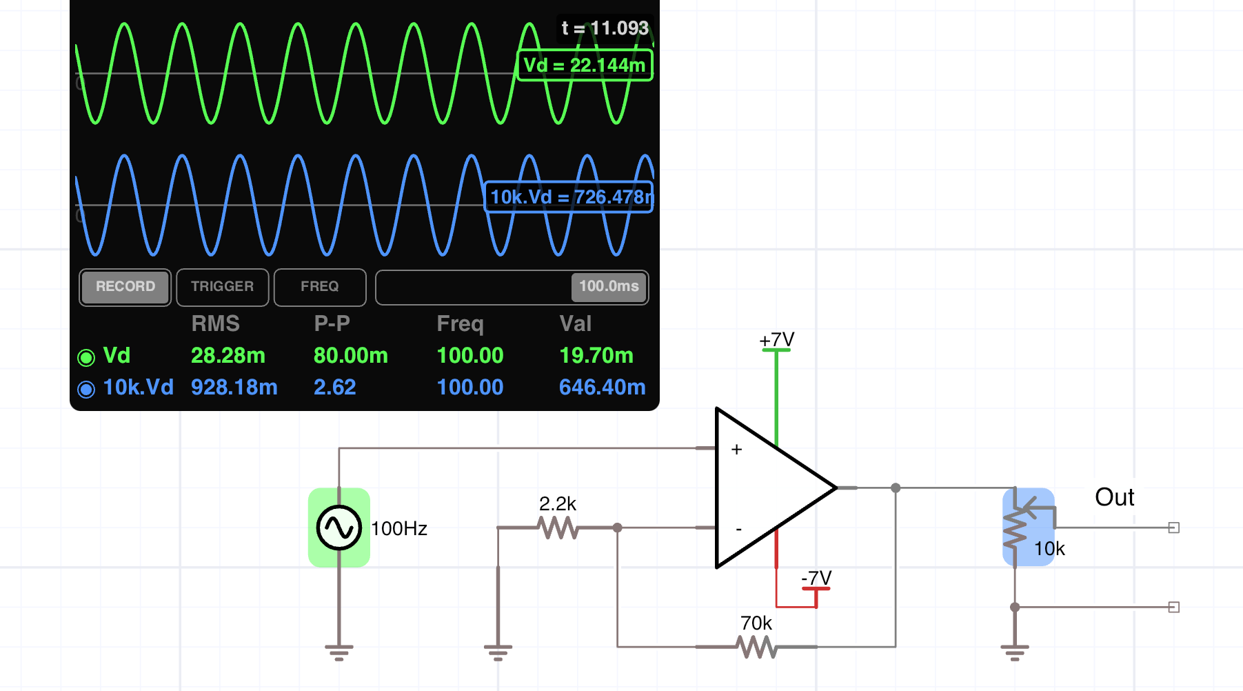

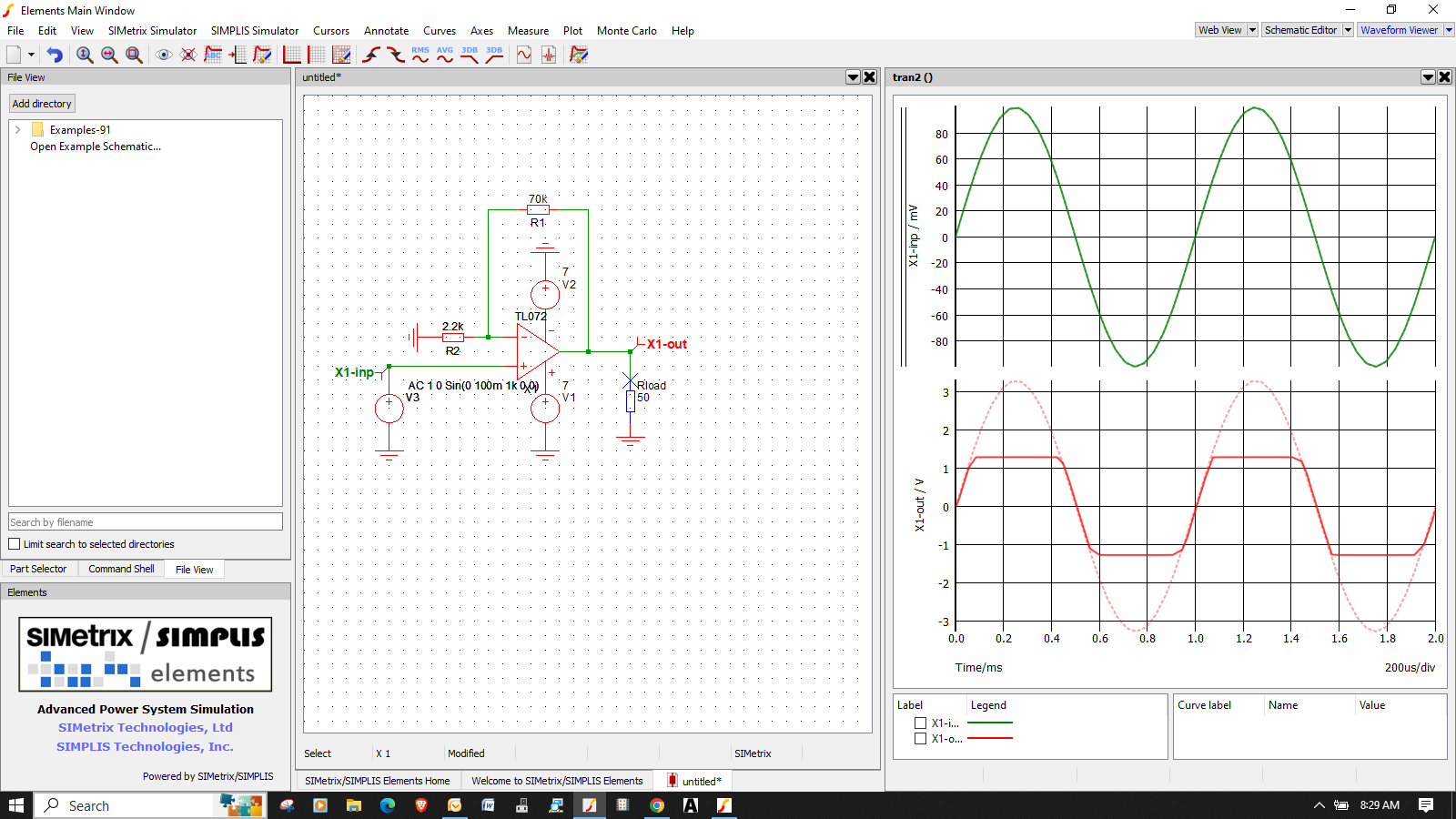

TL072 and Non-inverter small signal amplifying
If your supplies had been +/- 15 on OpAmp you could have
gone to at least 140K on pot. A G of ~ 65. Note for input of 100 mV.
Regards, Dana.
The input C of OpAmp inputs quite small, and a small amount added due to stray C due to layout.
No need for the 68 ohm R's.
Your G thru OpAmp is 1 + Rvol_control (K) / 2.2K. Any chance at extreme end of volume control
it goes open, very high Z. Which would cause severe distortion. Same could happen on the 0 ohm
end if real cheap pot. If thats problem obviously get quality pots, or use an additional fixed R from
output to OpAmp inv input to set max gain.
As Tony mentions regarding output load its way to low for this OpAmp, look at the datasheet charts
load current versus output swing. Its obvious your load way to large (= Rload way too small).
Laslty note you have to handle load dump in vehicle, eg. excess V, to keep from frying components.
Like bypass caps, semiconductor in general.

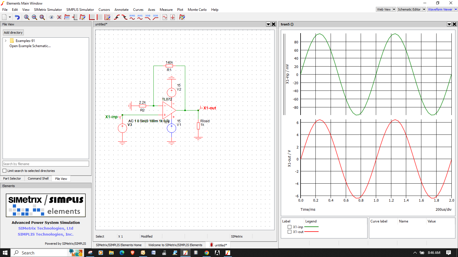

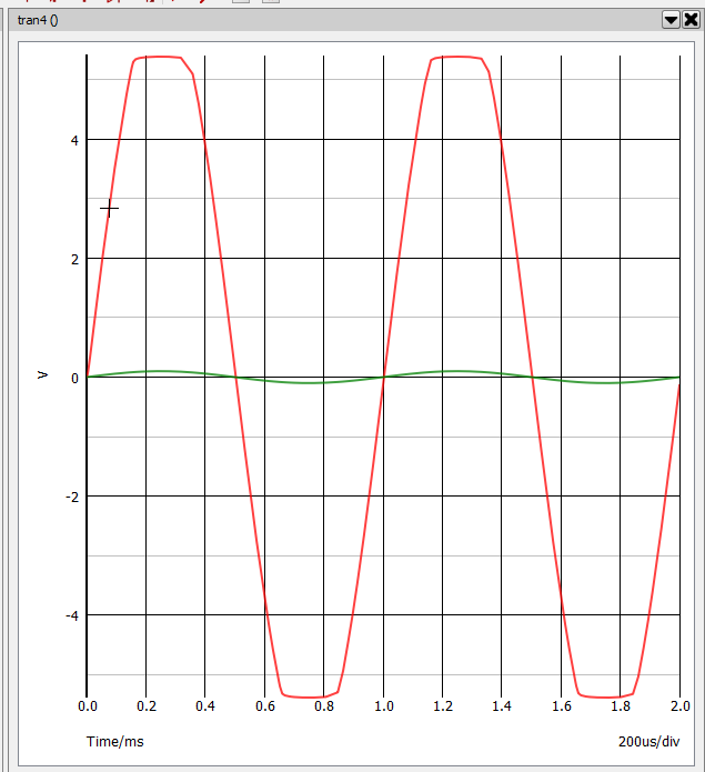

Notice the effect of a 50 ohm versus 1K ohm load on output :
Feedback Rfeedback of 140K, clipping evry evident :
Regards, Dana.
This is not the cause of the reported problem, nor was my illustration intended to be a solution. Rather it only shows the lowest load for 2Vpp.
I suspect that what has not been shown in the actual layout must be a problem or that higher output with clipping was used without stating the required details as what kind of distortion exists.
Is it amplitude sensitive? or not?
How far is the pot located?
What value was it when distorted? 70K? that is too much gain for 2k2 input for a gain of 25. It should be 55k Max. You can increase 2k2 to 4k ( or 3k9) to reduce the gain to 100k/4k = 25 rather than 55k/2k2 = 25 (iff your pot is 100k)
More details in future speeds up problem solving.

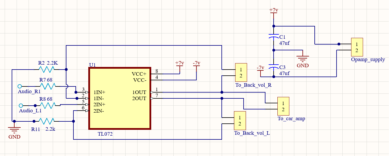

I have distortion problem in Audio_R1 and Audio_L1 when I turn the double volume which is To_back_vol_R more than ~70K .
Sure sounds like he has too much G. As supported by the sims and the low supply V's.

The answer is simple, leave the master gain HIGH, if not fully up. You've never provided any schematics yet, so we've no idea how you're connecting things, but a power amplifier is usually designed for full output with about 1V input, with the volume turned right up. You can't increase your gain to exceed the 4.7V or so you've got, that's a limitation of the power supply, and there's no need to, and no desire to - the master gain full up is how it's designed.
Have you added coupling capacitors to your preamp yet, it's really something you should have.

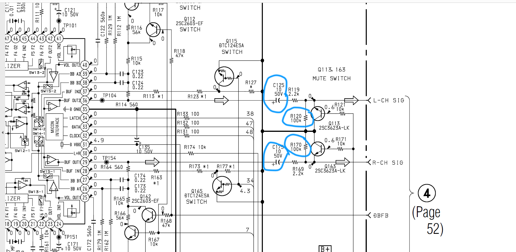

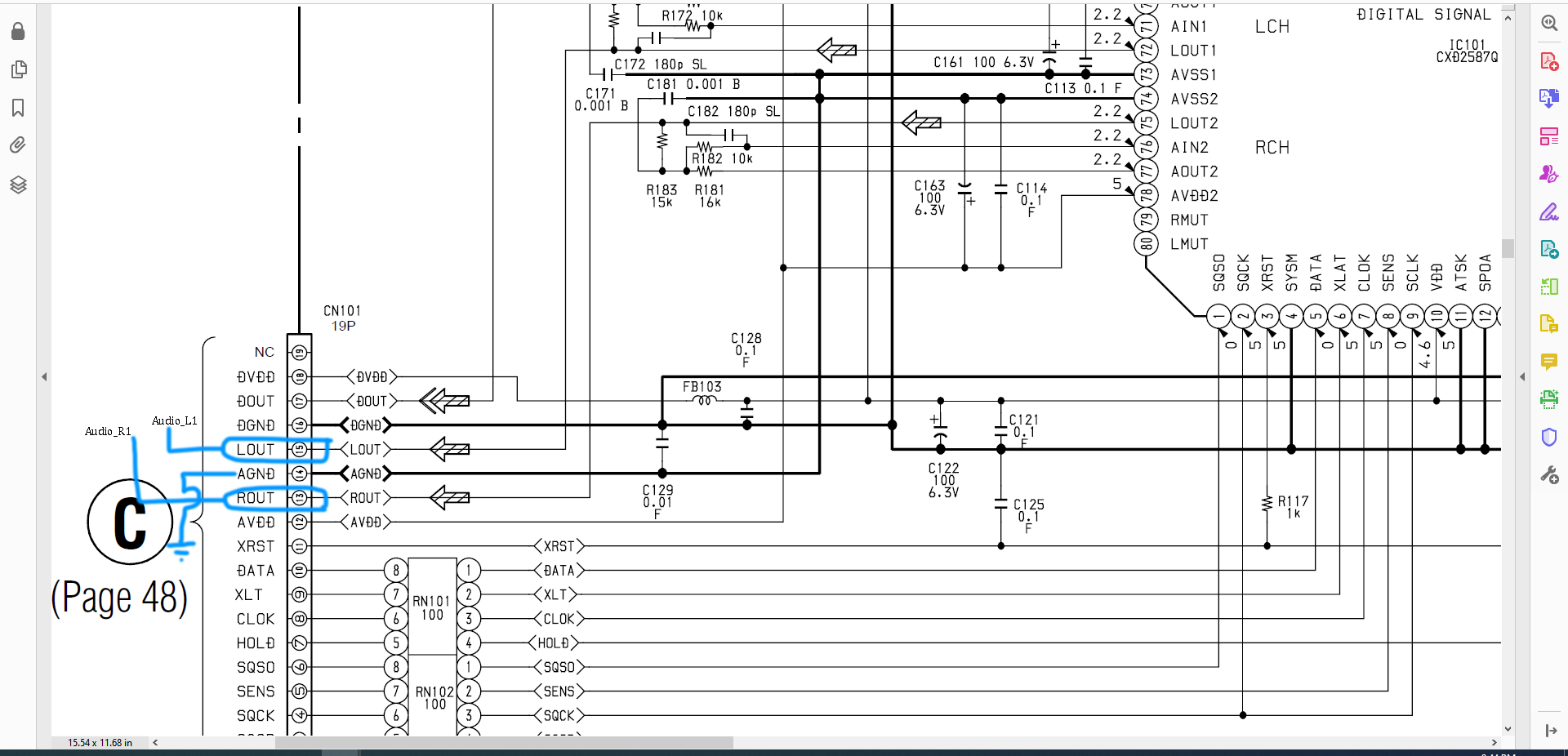

I have found the Master schematic :woot: full PDF is in first post.
There is the spots that I got my wires from Master AMP.
PAGE 39 of PDF in first post of topic :

The "master amp" shows a DC path to a what appears to be a 2.2V bias voltage on its outputs.
You MUST have a series capacitor between that and the opamp + input, as Nigel said much earlier on.
Try eg. 10uF with cap + to the master amp side.
You then need a resistor (100k?) from the opamp + input to 0V to prevent the input floating.

I think the problem is that you are confusing gain and volume.
For gain, you are adjusting the feedback resistance and, even though they are labelled "50k", they have a +/-20% tolerance (typically) so, if they are off on the high side, you are over amplifying and causing clipping. Moreover, you are using a potentiometer (voltage divider) as a variable resistor (rheostat).
To do it properly (in my book), I'd set the feedback resistance to the maximum value without distortion using fixed resistors and then use a potentiometer wired as a potentiometer for an output volume control (like most circuits use). That way, at max volume, you simply be sending most of your signal to the downstream power amp as an undistorted signal.

I have checked deeply the schematic and saw this:
Actually both capacitor and that resistor is available in Master-Amp. I have checked again all information and circuit . I think problem is ±7V power supply of non-Rail to rail opamp that I used . I am trying to find a rail-to-rail op-amp for my project . Any result I will release it here friends.
I have changed the supply voltage to ±10.5V ( to much problem to provide low noise and clean voltage :arghh: ) instead of changing op-amp to rail-to-rail .
Now the distortion of output of TL072 is around ±9V instead of 6.5V when supply voltage of TL072 was ±7.
But still I have noise on Master Amplifier (and also Slave amplifier) when G > ~30 ! Thus the problem is negative feedback .
