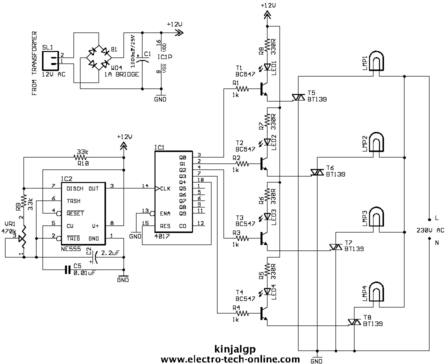

Hello hayato
i've found this schematic under Electronic Content/Electronic projects page 2 posted by Kinjalgp in 2002.(10 channel light chaser)
Could I, change the 240v lamps for my 12v ones, adjust the 555 part of the circuit to the desired 2Hz frequency, and add in your diodes to get light flow effect i'm after as in your #2 design
Can i run a 555 monostable as you suggested, via the enable pin to hold it on for 5 minutes
Or am i missing something ?

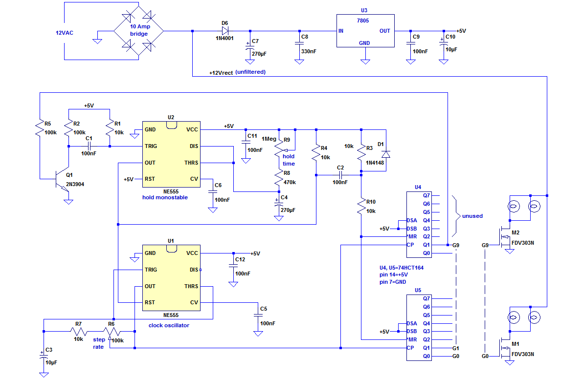

Henners, here's a version that uses shift registers. It may be a little more complex than the 4017 circuit, but you might as well have it as an option.
I haven't tested it, so if anyone sees any problems, please post them.

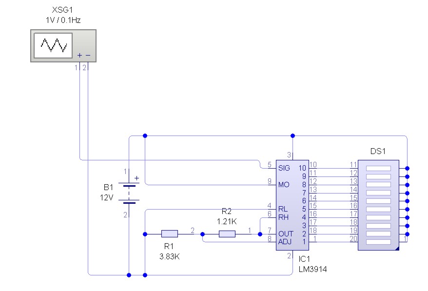

Started this but didn't get too far. Instead of a triangle wave, I wanted a linear ramp. Couldn't find what I was looking for in that area. Anyway, this is what I had in mind, just need to use a ramp, and do the out puts for your lights.
