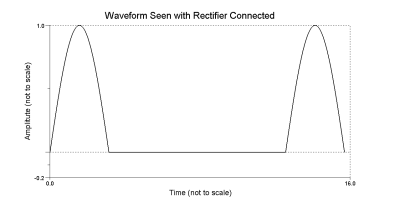

Here's a rough plot of what it looks like with the bridge attached. It's almost like things are being half-rectified instead of fully-rectified and the pulses are event shorter than in my plot. You might say their duty cycle is 5% - 10%. It's like the voltage can't stay up for the rest of the half-sine.

which means you are trying to use diodes that you would be lucky if they worked through the audio range at triple that.
wait on the better diodes
Ok, so the heat in the core is due to the core not being able to handle the power and frequency, it represents wasted power, reduced efficency and can eventually lead to device failure. Some iron powder cores will melt if used for this application, such as the yellow-white filter choke cores in computer SMPS. Can you attach a picture of the core or a good description?
The 1N4007 can't rectify properly above 400 Hz. Faster than that, and the diodes cannot "close" fast enough and current flows back. In semiconductor parlance, that is called recovery time.
You have to use a ultra fast recovery diode. Google it.

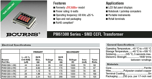

Here's that image. This type of transformer has other functions I need to investigate, so I prefer including it vs. something else like a cascade multiplier. I might add a cascade in addition to it, but the transformer stays.
Speaking of the cascade multiplier, what volt rating do the parts need to have? Is it the expected output voltage, twice that amount, or some other margin?
