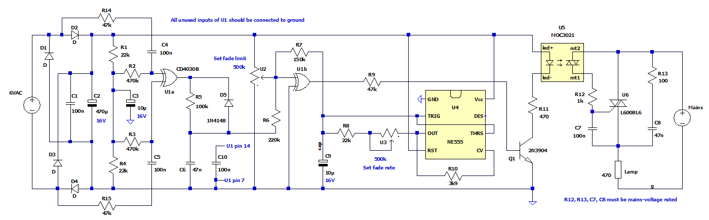

I am busy with my son's project and need some help, at the best of times I have problems replacing the batteries in the remote so your patience is appreciated. After spending many hours on electronice forums I have afirm understanding of the technical jargon but lack the "design" experience to complete this project.
I require a 220VAC lamp to fade in and out in a continuious cycle and be able to adjust the fade time. The "in" and "out" time must be the same, so 10 s to fade in must also be 10 s to fade out.
I have looked at maybe using a saw tooth generator to trigger a 220V lamp dimmer circuit but it keeps blowing up, as I said before I lack the design insight, I tried to modify existing circuits to suit me needs.
Any help would be appreciated
