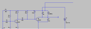

Hey thanks for the help sir... i initialized my work few weeks ago but I am unable to get the frequency modulated signal in the output. It gives AM signal. I tried in both proteus and in LTSpice. Can you show me where am I wring please? I have already tried a lot of circuits I found, like from audio guru and many others.

It's not a 'real' transmitter, it's just a toy - it gives both AM and FM modulation at the same time.
As Nigel says, that is not a good FM design.
The simplest improvement is probably to add a varicap diode. A 1N4007 usually works pretty well!
For your circuit, try this: Disconnect the right hand side of C2 to start with. Connect the diode cathode to V+ and its anode to the collector with a small cap, eg. 47pF should be reasonable, at a guess.
Add two, 1M resistors in series across the supply and connect the junction of those to the diode anode, to reverse bias it at around half supply.
Then connect either an RF choke 10K resistor to the right side of C2 and also connect that to the diode anode.
You will have to re-tune the circuit. Hopefully that should then give a better FM signal??
You may have to try different diodes, as the varicap effect is usually good but not consistent from one to the next.
I'd also suggest adding a ceramic cap such as 0.1uF across the power, rather that rely on the battery passing all the high frequencies.

I changed the position of ground connection, took antenna from the upper blank wire and got similar result as that of Frequency Modulated wave but I don't think it will practically work does it?

Also the circuit you have does not modulate the reactive impedance of the
tank network, seems to look more like a AM mod circuit.
Here is a circuit where a varactor is used :
Here D2 changes its C with applied modulating V, which is reflected across tank to
change its resonant freq.
Regards,. Dana.

Your capacitance of 10nF for your C3 is 21 times higher than is needed and it cuts high audio frequencIes like an old AM radio or old telephone.
All FM radios have de-emphasis (treble reduction) then all FM transmitters have complementary pre-emphasis for good sounds. Your simple circuit is missing pre-emphasis so a receiving radio will sound VERY muffled.
