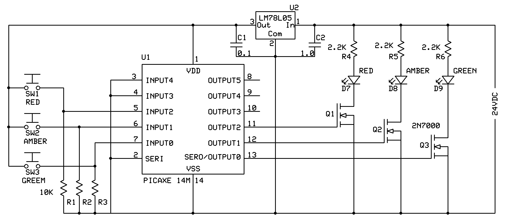

Thanks to everyone for the help so far. Just to clarify what I actually have.
I have 14 stainless steel plates with 3Nr illuminated switches in each, one green, one amber and one red (see attached photo). I dont want the switches to do anything other than turn the integral led on. My problem is that the switches are momentary switches not latching ones and thus what should have been simple is now a bit more complex.
As I see it, without changing the switches or adding anything else to illuminate the led there are two options:
1. The prefered option would be to press any of the 3 buttons, the led on that button would illuminate and the other two would be inhibited, if another button is pressed then that led illuminates and the one that was on goes off. so at any one time only one of the leds can be illuminated at any one time.
2. The other option is to have each switch as an individual, i.e you press the button the led lights up, you press it again it goes off. This switch is not linked in any way to the other two so potentially you could have all 3 leds either on or off.
3. The other thing i considered was installing a 3 position key switch, the thought being that you switch to whatever colour of led you want (the switch section on the illuminated units I have would therefore be redundant). The problem I have here is that the bezel and bit where the key goes in must be stainless steel as the cleaning chemicals used in the facility will corrode plastic, chrome plate etc etc. I cant find one anywhere, does anyone out there know of any manufacturers?.
As I am a novice in electronics I need a very simple diagram to follow, the diagrams in my first post are very easy to follow and something like that would be fantastic.
Many thanks
Lee

LeeH68,
I had to take one more whack at it. This should work for Solution #1
I'm using a small, programmable, micro-controller chip (PICAXE 14M) to sense the pushbutton switches, and select the correct LED to light. An added feature could be a power-failure indication . If the 24V power went out and came back on, the microcontroller could flash all LEDs indicating you need to reset the selection. Or a selection recovery....the microcontroller could store each new selection, and recover the last selection when the power returns.
This could be assembled on a small printed circuit board, and mounted, somehow, inside each panel. There are companies that will layout, make, and stuff the boards to your spec's...for a price :)
Ken

Could. Takes a PC, a serial cable, and two resistors for hardware. Free software. So once written, they can roll their own. :) But wouldn't do it without all the hardware in hand and a lot more details...you never know what you don' know. :(
Ken
Ron,
OK, I had to do it...for fun. :) The software works. :D
Ken

Ron,
Thought that since I said I did it, I should prove it. ;)
When the circuit is first powered there is no previous selection stored, so all three LEDs flash on and off as a warning. When any pushbutton is pressed, only the corresponding LED is lit, and that selection is stored in static ram. Subsequently, when any other button is pushed the current LED goes out, the new LED is lit and the new selection is stored. If power is lost and restored, the program recovers the last selection, and lights that LED.
Ken
P.S. The program has only been tested in the PICAXE simulator!

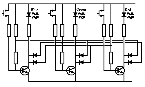

It just seems to me that things are getting unnecessarily complex here and that some basic things are being overlooked.
Like I think the switches are rated up to 24 V and everyone here has assumed the OP wants to use 24 V. Or am I missing something?
I think this would work and it only requires 4 resistors, 2 diodes and one common transistor per switch.
The idea is that when one transistor is conducting it prevents the other two from doing so. Pressing the button starts that transistor to conduct and stops the other two. I cannot find any flaws.
Others can review it and calculate component values.

HS3,
I think you may be right about the 24V's...and our assumptions. Maybe Lee could tell us what power supply was already in his system. ???
I had to try out your circuit, so ran it in a TINA simulator. 12v supply, 1k resistors for the LEDs and 10K for all others. All LEDs lit on initial power-up...then 1-of-3, as individual buttons are pushed. :)
Thanks.
Ken
