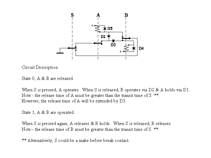

You did not say how you want to release the solenoid. If it is to be released by another button, then all you need is to latch the relay with one button and open the circuit with another.
This one will latch at the first button press and release at the second press.
Note that the operate and release times of the relays need to be at least 10 ms otherwise they may respond to contact bounce.

Thanks for all the ideas. I'm going to go with the Latching Relay because I've found somewhere I can buy on locally (it's called an Impulse Relay but it seems to be the same type of thing). Also it's the simplest option to install. If that doesn't work then I'll use the 2 relay circuit as it looks ideal, thanks Len. (it's a second press of the same button to release the solenoid).

Mike, if you want to use the 2 relay circuit with a SPST button rather than a SPDT one as drawn, I can show you how to do it, but it needs a transistor and 2 or 3 resistors.

I agree, however a transistor and a few components may be cheaper and consume less PCB space than another relay. Another consideration is that the contact transit time of the third relay may be excessive if it has a diode across the coil to suppress the back EMF. So the diode may need a rresistor in series.
