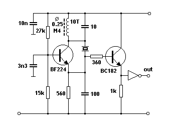

The picture of the crystal is not much help, it is impossible to determine the characteristics just by looking.
I suggest that you build the oscillator using the basic inverted circuit and measure the output frequency, if it is 27 Mhz - you have cracked it!
If it is only 9Mhz, you need an overtone circuit.
Read the article in your link, it gives information on how to make an overtone crystal work in that circuit.
This will work...

A crystal operates by mechanically vibrating at the required frequency. For low frequencies a larger piece of quartz is used than for higher frequencies.
As the frequency goes up, the piece of quartz gets smaller and thinner, eventually it gets too small to be practical.
So for higher frequencies, the quartz vibrates on an overtone, 3, 5 or sometimes 7 times the fundamental frequency.
Just plugging a crystal into an oscillator will usually result in it oscillating on its fundamental frequency.
If the oscillator is designed for overtone operation, the crystal can vibrate at one of the overtone frequencies.
A 27Mhz crystal I would expect be a 3rd overtone type. So to operate at 27Mhz you need an overtone oscillator circuit. If you put the crystal into an ordinary oscillator you will get the 9 Mhz fundamental.

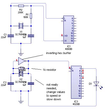

are you sure 27MHz is not too fast, some chips will not much. for example:
a 4024 will not take more than 5MHz.
i don't think you will need caps if you want full speed leave them out
i have tested bothe of these drawings with and without caps.
danielsmusic, I used thouse circuits when using 32KhZ and 4Mhz crystal, but I don't know if it would work with 27Mhz. also, I don't know how to calculate the caps and resistor values for sure, for a certain crystal...
