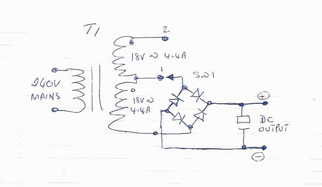

I have a 52V transformer that after rect. produces 3.3A at 52V. I wish to use either a LM317 or a LM338 with 2N3055 power transistors.
If you run 2N3055's in parallel you are suppose d to have a resistor like a 0.1Ohm 10W from each emitter so that thermal runaway doesn't take place.Surely the resistor should be at least the output in watts ?
There are circuits on the Internet with this resistor on the base or collector but I think the emitter is correct ?
Could you possibly tell me how to calculate the value - Ohms and watts of this resistor. ? I understand this can be critical.
Honestly the Internet can be a nest of worms, there are many circuits that don't use a resistor at all.
On her page is a link to the circuit that states she removed the 0.1 Ohm 10W resistors as it limited her current output. This 20 odd Amp supply works fine.
Please advise.
I was considering using 4 x 2N3055's each at about 0.75A at 52V (39W each). I thought 3A from the transformer a safe limit. 1 heat sink per 2N3055 in an x pattern under a 125mm 0.5A fan blowing from outside the case down the heat sink fins with a 30mm gap at the bottom. The rear of the case is all vents. I may fit a 150mm 0.4A fan if the 125mm doesn't cover the heat sinks.

The emitter ballast resistors should be used. At an emitter current of 0.75A, a 100mΩ resistor only drops 75mV, and dissipates 0.075V*0.75A=0.056W. I would shoot for a voltage drop across the ballast resistor of at least 500mV, in which case you will need to redo the math and calculate the resistance and wattage required.
Nope. After the rectifier there must be a pretty big filter capacitor that charges to the peak voltage minus a couple of rectifier volts (+71.5V).

As MikeMi has stated, always use emitter ballasting resistors.
Dropping 500 mV at full load is a good rule of thumb. You could lower this value perhaps a couple hundred mV if you employ beta-matched transistors and they are also thermally-coupled very tightly.
Also.....AG's assessment of what the rectified and filtered DC voltage is correct. Over 70 volts at nominal line input voltage, expect 10 or more volts at high line.
Does it have a center tap? If so, the DC voltage would be halved.

Probably John is getting 52Vdc. So the transformer produces about 53 volts PK, and 36 or 37 volts RMS. So the transformer is rates at 36 volts.

Hi audioguru. The transformer is for 36V 4.44A output at 230V. My mains is 245V so 38.34V X 1.4141 = 52.44 . I have a 10,000uF cap after the bridge rect so about 51V. Sorry about the confusion.
Hello shmitt trigger. As I thought I was building a 36V power supply (I had forgotten 1.4141 - it's 50 years since I last dabbled in electronics) I don't mind loosing a few volts. I'll use those resistors.
The transformer is tapped for 110V and 230V input and 2 x18V or 36V at 4.44A output. https://cpc.farnell.com/multicomp/mcta160-18/160va-toroidal-2x18v/dp/FF01565.
Hello ronsimpson. I made a right cods explaining that transformer - sorry. As I said above I have a 10,000uF 63V cap - mind you it's from China so who knows. I'll wear safety glasses and a flak jacket for a while. Maybe I should but a 100K resistor across it, sound a good idea.

You mention about possible problems with the quality of your reservoir capacitor. I expect that you know that the normal scam is to put a small capacitor, say 1000uF capacitor n a big can marked 10, 000uf say. But many capacitors are genuine.
When you are designing a power supply, like yours, you needed to know the ripple voltage on the reservoir capacitor. You can get pretty close to the peak to peak ripple voltage as described @ https://www.electro-tech-online.com/articles/two-simple-formulae-capacitance-and-inductance.783/
In your case, with a 10,000uF (0.01F) reservoir capacitor and a current drain of say 1A, the ripple voltage can be calculated by V= IT/C, where V is in Volts peak to peak, I is in Amps and T is in seconds. As you are in the UK your mains frequency will be 50Hz, giving a period of 1/50 sec = 0.02 seconds. As you nave a full wave rectifier T becomes 0.01 seconds because the reservoir capacitor gets charged twice for every cycle of the mains. So the ripple voltage would be: Vripple= (1A*0.01s)/0.01F = 1V p/p.
At 2A current drain the ripple voltage would be 2V and at 0.5A drain the ripple voltage would be 0.5A and so on.:)
As has already been said, a bridge rectifier and reservoir capacitor will produce (52V *1.414) -(2 * 1V) = 71.5V across any value reservoir capacitor (in practice over around 1nF) with no current drain from the reservoir capacitor.
But, as you take more and more current from the reservoir capacitor the ripple voltage increases according to the Q=CV=IT formula. But also the transformer voltage drops, mainly due to copper loss (resistance of coils). A very rough rule of thumb is:
(1) Take a transformer/rectifier/reservoir capacitor power supply with a transformer winding rated at x Amps RMS,
(2) if you take a DC current equal to the magnitude of the rated RMS coil current from the reservoir capacitor, the voltage across the reservoir capacitor, at the peak of the ripple voltage, will be equal to the RMS rated voltage of the secondary (if that makes sense)
This is a very rough and ready rule which varies from transformer to transformer, but it gives a good starting point for a design design.

I have seen 'centre tap' circuits and had a quick look but I'm afraid it was a case of 'duh'.
However, this transformer I have is 18VAC x 4.44A + 18VAC at 4.44A therefore I think centre tapped ?
I had it wired for 18VAC at 8.88A. I did check I could with CPC Farnell first. I then decided on 36VAC at 4.44A.

Is it possible to switch between 26V DC x 3.3A and 52 DC x 3.3A. I don't think I see a problem with the switching arrangement at the output from the transformer. Would everything that follows on work ?

... this transformer I have is 18VAC x 4.44A + 18VAC at 4.44A therefore I think centre tapped ?
Is it possible to switch between 26V DC x 3.3A and 52 DC x 3.3A. I don't think I see a problem with the switching arrangement at the output from the transformer. Would everything that follows on work ? If you halve the difference in Volts between Input and load then you would halve the Watts on the 2N3055's - and heat ?
Yes, you can do that quite simply. In fact, it is normal procedure in power supplies to reduce the dissipation in the output transistor as you say. A suitable circuit is shown below.
