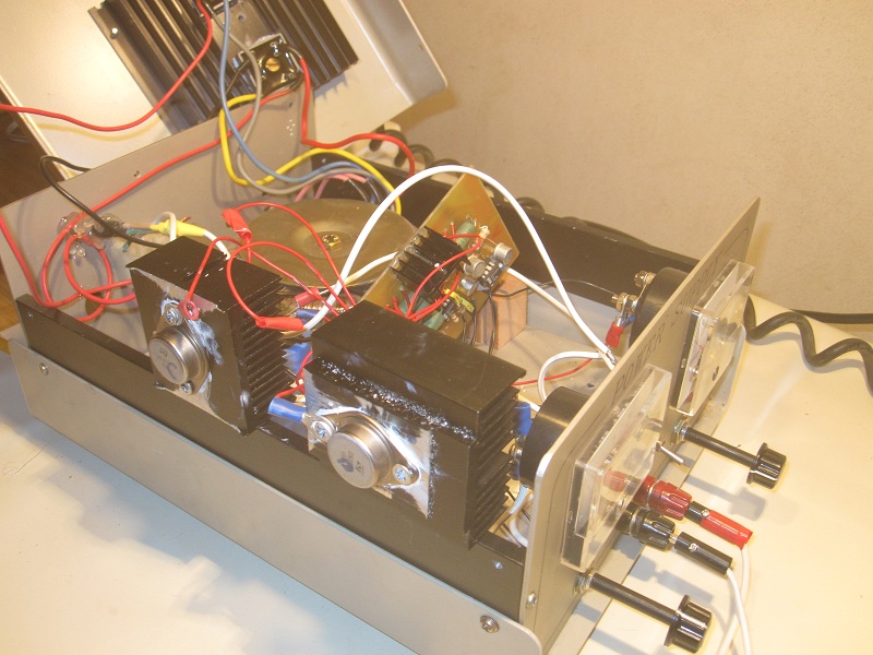

I'm building a power supply that uses the 2N3055. But now, after these transistors reached their breakdown temperature the 2nd time, I was wondering, would it be better to use the TO218 package TIP3055. Which one would dissipate heat better? If I was to use the same heatsink

Are you using thermal grease to mount the transistors to the heat sink? If so then you need a better heat sink. How much power are you dissipating and how large is the heat sink?
Yes, i am using thermal grease, 100Watts of heat is going to be generated, and the heat sink is that of an old CPU. One for each transistor.
The datasheet gives the max heat dissipation as 115W
115 watts with an infinite heat sink at 25C.
You don’t have an infinite heat sink at 25!
The TO-3 case is rated at 1.52C/watt. There for at 100Watts the junction is 152C above the case temp. If your heat sink was 25C then the junction temp would be 177C. The silicon breaks down at 200C. You heat sink is not at 25C. You are milting silicon.

But the max operating temperature is 200'C. And that "100Watts I'm talking about, is only at full power operation of the power supply, namely 50V 2A.
WHOA, WHOA! HALT! I made a big mistake. My Vin is 54 Volts, my Vout is 45 Volts, and my Iout is 2 Amps.
Thus it gives me a total loss of heat of 18 Watts. I should do some more research before asking stupid questions.
Sorry everyone.
But I still don't quite understand what thermal resistance is.

Are these heatsinks large enough? I now know how to work out the heat generated, but how do I find the required heatsink?
You work backwards from the maximum ambient temperature and forward from the power dissipated. From that you can determine the maximum thermal resistance you can tolerate for the heat sink which will dictate the size of the heat sink.
