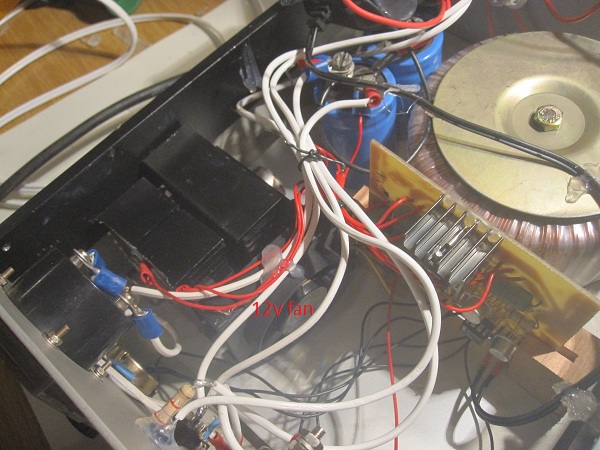

You work backwards from the maximum ambient temperature and forward from the power dissipated. From that you can determine the maximum thermal resistance you can tolerate for the heat sink which will dictate the size of the heat sink.
POWER DISSIPATED=18WATTS
max ambient temp=40'C (just in case)
What now.
I know you must be pulling the hair out of your head in frustration, but please bear with this newbie.
Nice looking box!
AAVID.com and other heat sink makers have data sheets. Often they show temp rise in free air and with airflow of x-feet/minute.
You need airflow. Heat sinks often face out the back of the box. In PCs they have a fan blowing on them.
You can put a temperature meter on the transistor. Do the math to get an idea of case temp verses die temp at 18 watts. Because we do not know what heat sinks you have, and do not know airflow then just measure the transistor.
I already have another thread running, about the airflow problem. I'm going to use 2 computer 12vdc fans, run directly from the 50V rail (with sufficient resistors of course). Oh, and those are old CPU heatsinks. The heatsinks are just where they are in the photo for demonstration purposes. They will later be mounted in the back of the box. Now it's up to me to try and make the holes for the fans. which will be quite hard, since I don't have a circle drill of that diameter.

OK. So just calculate the total thermal resistor you can have.
Assume a maximum junction temperature of 150C for safety. Then the maximum allowed thermal resistance to air would be (150-40)/18 = 6.1 C/W. From this you subtract the transistor Junction-Case thermal resistance of 1.5 C/W and another couple tenths for Case-Sink gives a maximum allowed heat sink thermal resistance of 6.1 - 1.5 - 0.2 = 4.4 C/W.

Are these heatsinks large enough?

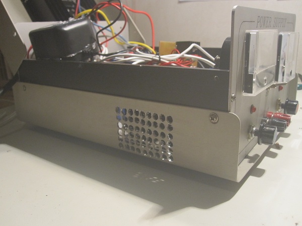

Those heat sinks look big enough for 20 watts, as long as they have free air flow through the fins. I cant tell from the pic if your cabinet has air holes, but if not you'll have to add some.
To test the heat sink, run the unit at full power for a while and measure the case temperature of the transistor. Using the data sheet, calculate the junction temperature and see if it is within reason.

I'm not sure what you are planning, but your forced air needs to flow between the fins of the heat sink
I'm pretty sure that's a bad idea? For a motor you supply it with the necessary voltage, thats all.

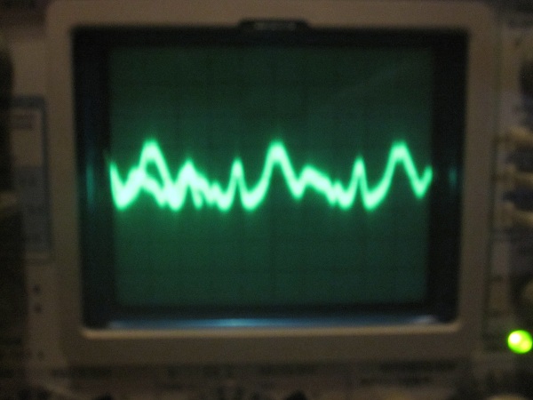

I just took an old 12v chargher, ran it from the 220V mains (in south africa) and powered the fan. It works great. Has about 10mV ripple on the output. Transistors run cool.
