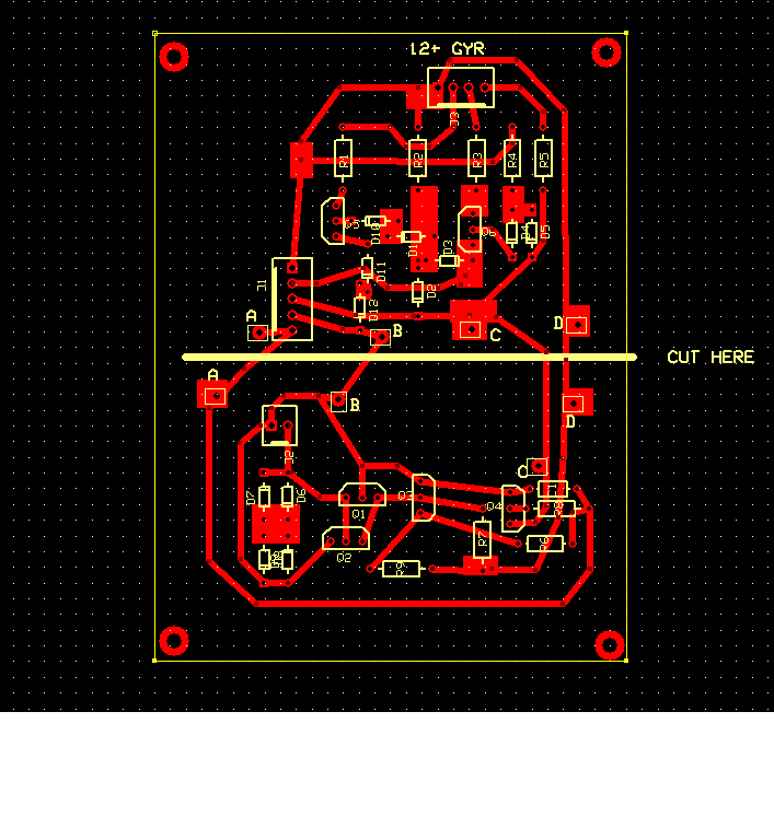

Any thoughts about a PC board design. MrDeb's board is fine. I don't know the measurements but if its small enough then I suggest you use it as a standard for your system. If you don't need a signal controler then just omit those components. As for size I tend to match the size of a PC board to the space availible. It makes the whole project maintainable. There is usually a lot of room under a layout so it makes no sense miniaturizing equipment. I use 4.5 inch square boards and I'm glad I made that decision because as my system's capabilities have expanded I had enough spare PC real estate to add and move things around. It's also nice to not have to use tweezers to remove components when experimenting.
What I sent you is what we in the industry call a 'lashup'. Before we put a design in concrete we use a hacksaw to make a PC board by cutting straight lines into the copper foil. Well after everything worked it was too much trouble to redesign a board so we just etched the lashup. Plan on maintainability and accessability.

here is the twin T with signals on same 3 x 4 inch board.
NOTE I saw mention of having two seperate boards, well MERRY CHRISTMAS
here is a board that has a cut line and marked jumpers for having the two boards seperate
will Email the file.

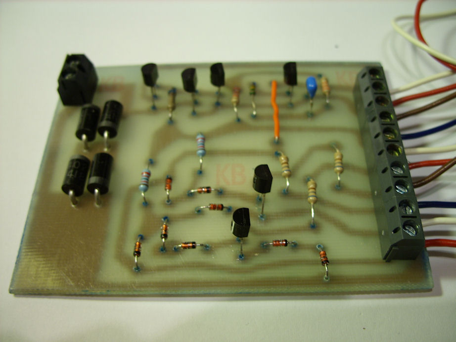

Ended up with a new more spread out design with the connectors on each end (track one end, the rest the other end). The prototype is built and works just fine. Initially had detect on all time but it seems the flux I use is very conductive and needs to be cleaned off after soldering is done.
I did end up using PCB Express as the auto router I found worked fine if I had been able to find a laser printer to use, but as I used a pen to do the tracks the lines were too close to other components to allow for them to be drawn. Maybe I'll use it in the future tho' :)

As I said to MrDEB, thanks for all the support on this. The prototype works and now I can bulk order. Took a couple of days to get it sorted what with other things going on here but now it's done I feel great :D
Will contact you by email re the signal build, talk through a couple of ideas I have. But the detector/signal circuit works just right.
