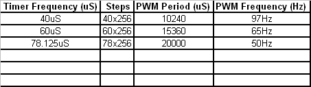

Hi I applied Mike’s code & it really worked well. So I’m really happy.
I research on TIMER frequency Vs PWM frequency & got best three values.
Here are they.
So always I must write the ISR without overlapping this timer frequency.
I like to dim 6 LEDs inside ISR.If there is no space then I have to alter the timer frequency according the graph.
Because i need to dim 6 LEDs inside ISR & need to do some other work in the main routine.
I think I can do that.
If I load d'128' for LED variables then it will dim halfly.
That means (128/256) X 100 = 50%
So this is how you tell duty cycle.Tell me am I right?
