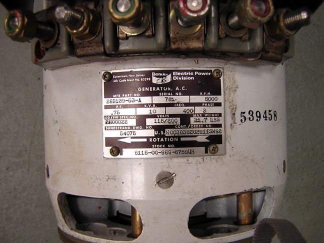

Is that all there is on the plate?
10kVA is the power of the generator, it isn't the voltage...
If the voltage isn't on the plate try measuring it...
3phase to single phase
ok this is all the info thats on the tag
i hope this will answer any more questions see attaachment
So, it produces 115 / 200 V
How much do you need? if you want 115V connect it in a "triangle" confuguration
Connect it in a "star" configuration for 200V
What do you want to power with it ?
The data label say: freq: 400Hz, i think this is some aerospace board device. The 3phase with 400Hz optimal for rectifying and you can use the DC power for bulbs, heating elements. You can also loading each phase independently. The 115V 400Hz good for any device with SMPS input.

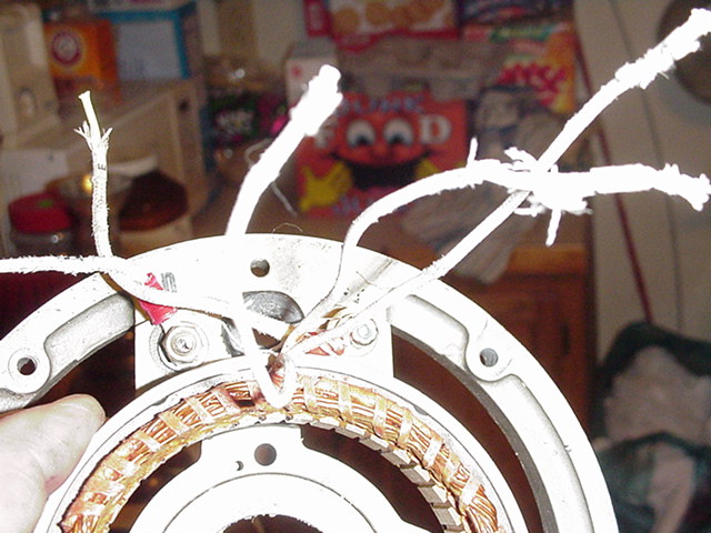

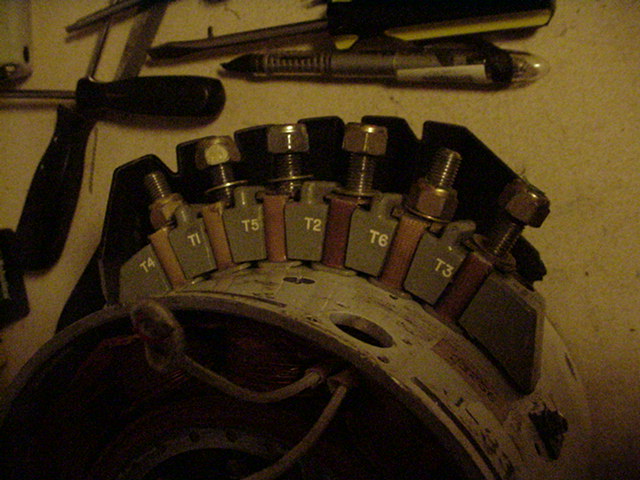

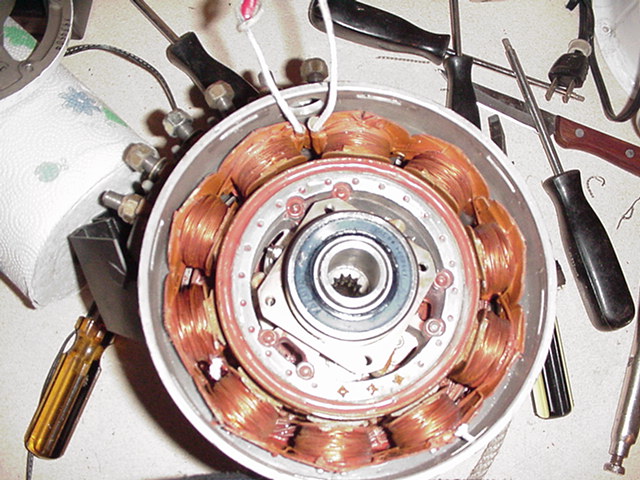

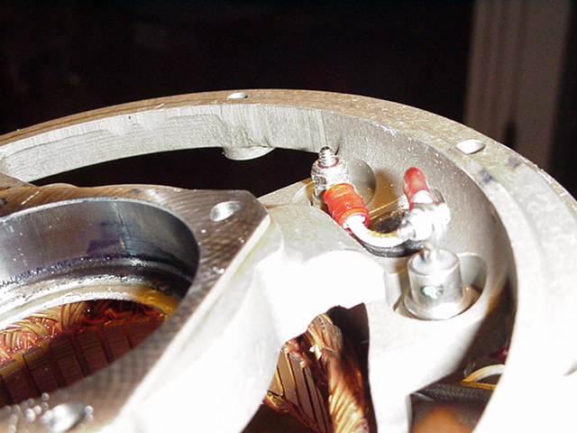

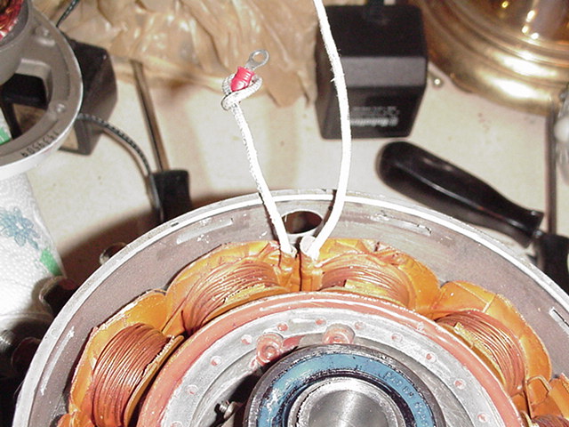

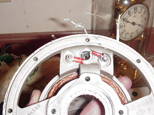

well now im realy getting ito things here im disasembling this unit just to see what i got and mabey to understand what to do with it and show you all to and help me better this device so here are some pics for you all to see

here are more pics because the web only lets in three at a time now im a bit confused because this small winding seems to be connected to the large winding inside the two wires comming from the large winding are connected by what looks like a diode and the three wires comming off the small winding go out to a small plug that has 5 wires

Hi eyeofthefly,
Yes, you are right.
you will get a lower frequency out by running it at a lower speed.
But,
you will also get a lower voltage output, you may need to increase
the flywheel weight, You may be able to counter with a step-up
transformer.
You haven't said if your house is 110/115 or 220/230 volts.
How is this unit driven?
Running an engine at one eighth of its intended speed may not be
practical. Maybe its pulley driven ?
John
just looking at the pics.
very interesting.
how is it driven?
what voltage is your house?
still trying to make out what that bit is with diodes on it.
it might be to feed the field ...
