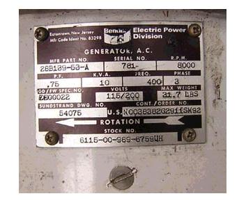

hi, could you clarify the makers code number, top left ?

here is the number eaton,new jersey mfr code ident no.83298 mfr part no. 28b139-53-a seril no. 781 r.p.m. 8000 p.f. .75 k.v.a. 10 freq 400 phase 3 gd/fw spec.no. ze00022 volts 115/200 max weight 31.7 lbs sunstrand dwg no. 54075 cont./order no. n0038382g2911sm92 stock no. 6115-00-989-679uh thats all the info thats on the tag i hope that it helps to get more info as i tryied serching the web but came up dry
