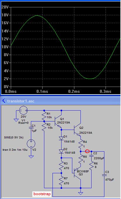

10Vpp outputs at 20V supplies is impossible, you need at least 22V supplies. Otherwise, use digital amp design. the digital design is possible to boost the voltage outputs, but worst distortion and emp.
Blatman Bond said:
10Vpp outputs at 20V supplies is impossible.
16V p-p is easy if you use complementary emitter-followers on the output.
The driver's load resistor could be bootstrapped for a high output level.

Oh.. sorry that was 10Vpp outputs, there was +-10Vout in my mind.
My thanks to audioguru, for my mistakes.
