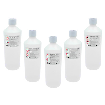

IPA still seems to be readily available on ebay.
eg.
eg.
I'm not sure I'd call 50£/5 liter bottle "available". It is IPA! not extra virgin olive oil from a remote Greek Island.
IPA should be selling under $10 per gallon for single-gallon quantities.
The operative phrase is "Lab Grade," free of mystery contaminants, suitable for controlled chemical processes, etc. That jacks up the price tremendously.
I think I've just found a local source of denatured ethanol for less than half the price of normal IPA.
I nearly bought 5Ltr of IPA off ebay for AU$25 (US$13) about 4 months ago. Now, 100mL is AU$20!!!
