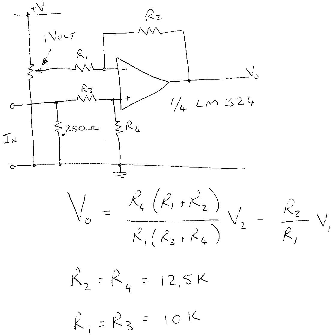

You could use another opamp to generate a midpoint to give a simulated split supply, or use a 7660 IC to generate an actual spilt supply.
Here is a circuit. I know that I designed this circuit before, but can never remember where I stashed it.
The easiest way to adjust this circuit is to adjust R1 for a 5 volt swing at the output, then adjust R2 for zero at 4mA in or 5V at 20 mA in.

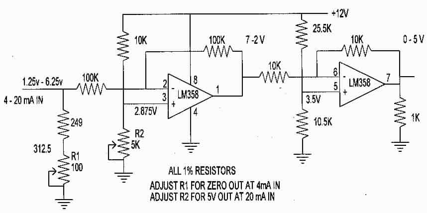

I have now tested the attached circuit and it seems to work fine. Can you please tell me if there are some issues that I need to consider.
Regards
Jurie
