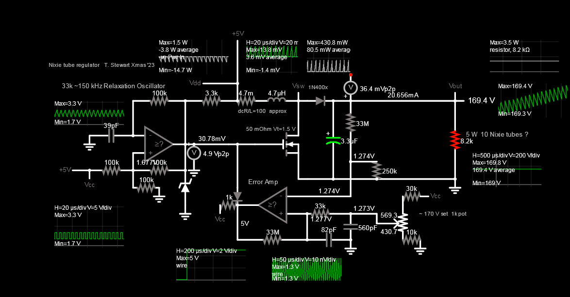

Coincidentally I designed one now using discrete parts. Dual high-speed open-collector comparator 50 mohm FET 30mA @ 170 V using 9V or more.

170 5W 92% efficient 1V error ripple <100 mV typ http://tinyurl.com/yp7zadrt
Is this good enough?
Is this TMI ? (too much info on simulation)
That simulation shows pulses every 5μs or so, and it's using a 1N400x, which has a reverse recovery time of around 2μs. I don't think that the reverse recovery time is simulated properly, if at all.
I think that 4.7μH is far too small for a practical converter that needs 2 mA. All the currents are changing far too fast and it would be far easier to have a much larger value of inductor, which would mean that the switch is turned on for a longer time. That would mean that there would not be as much need to turn the MOSFET on and off quickly.
Multiplying 5V to 180 = 36 and power is < 0.5W per tube, Although over designed, <4W in & 3.5W out peak current was >2Apk for speed with 0.1V ripple on 170Vdc
This Burp charger could be reduced in capacity from 2.9A for 100 us by raising L . But this has superior efficiency from 5 to 30V in and 0.5 to 5W out . Some might want more than 1 tube.
Reducing C load uF to nF increases ripple from 0.1V to several V, but reducing 5W to 0.5W by raising L can accomplish same.
It was just a quick and dirty design and may be easily tweaked to different requirements. ( It was far from perfect for everyone) One would normally use an IC for this.
TY for comments.

2us recovery time I simulated with cap across diode by simulator was too slow (run time) , but it worked fine with 5 us off time 100kHz .
If I reconsider start time as 2 seconds and only 0.5W out @ 170V or 1 J, then the 5V input needs to provide 1J/5V/2s = 100 mA average and with 50% d.f. a peak current for trapezoid current of 3 to 4 x average or 400 mA peak in theory or 0.5A with losses in higher L DCR using 100:1 ratio for R/L which is more gentle and well with USB limits.
I didn't have time to create a better diode model, but you are right, always choose a fast recovery diode or run it at 50 kHz and deal with peak currents in DCM.
