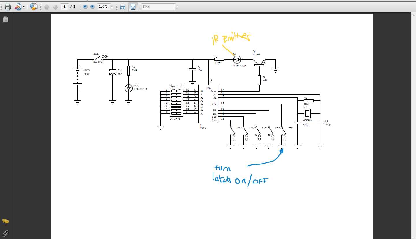

Ok here it is....I have a project in for Thursday, ive been tearing my hair out for weeks trying to get this to work. My problem is:
Button 1 + 3 moves motor A clockwise.
Button 2 + 4 moves motors A + B clockwise.
Motors latch, it should be momentery, stop when button is let go
It is supposed to:
The buttons should be momentary
Button 1 should move motor A one way
Button 2 should move motor A the other
Button 3 move motor B one way
Button 4 move motor B the other
And be momentary.
Are my positive wires position causing the problem?
Will

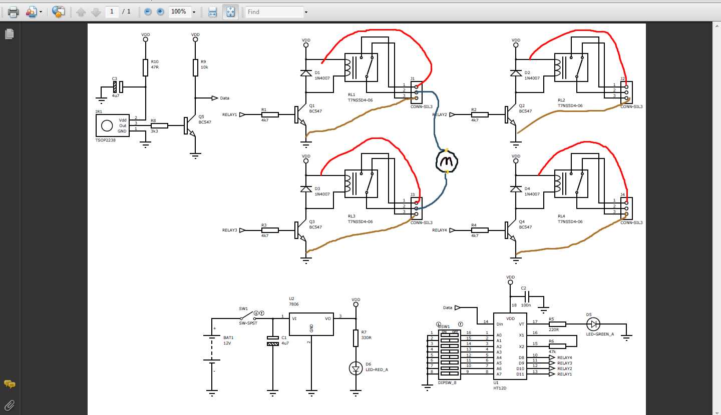

The HT12D is latched. The HT12F is momentary.
To use the HT12D in momentary mode the output must be gated with VT (valid transmission).
The intended result was:
Switch 1 rotates motor A left
Switch 2 rotates motor A Right
Switch 3 rotates motor B left
Switch 4 rotates motor B Right
It is to opperate a household spotlamp to aim to any point in the room.
what actually happens is:
Switch 2 rotates motor A + B left
Switch 4 rotates motor A + Bleft.
Im not sure if the positive off the relay is going to the correct point. It has to got to a positvie so I stuck it to the closet 6v
Will
