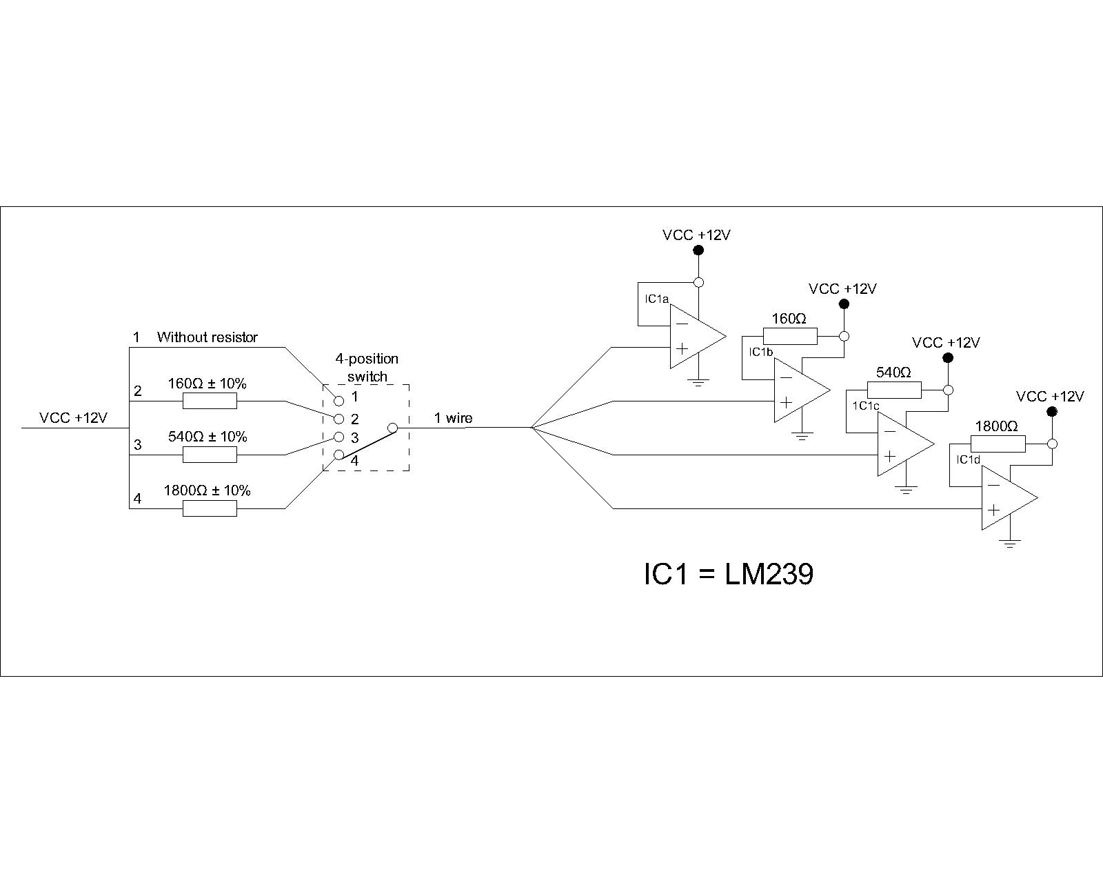

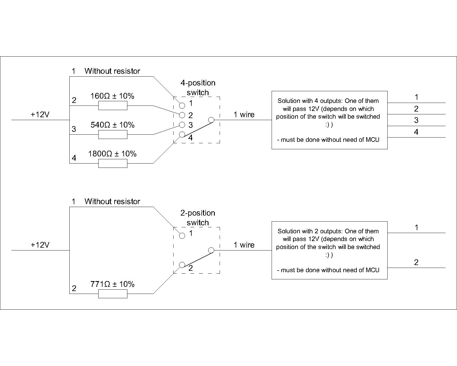

Hi there,
need help with decoding 1-wire output from switch (each position another resistance)
Thanks a lot
Can you see how it would work if you put a 500Ω resistor from the MCU input to ground? Try working out the voltages when the different switches are closed.
I will rather modify the picture, cause, there is no MCU.
Just 4-position switch with added resistors to each position, and the output of the witch is single wire. And I need a device with four outputs which will recognise, which position was switched. I dont want it done with MCU, cause I dont have any experience with it.

In that case, I'd say a quad comparator, or a quad opamp as a comparator. Each comparator has a voltage threshold, say 2V, 5V, 8V. and 10V... the inputs to the comparators are tied together, along with a resistor to ground. Using your switching resistors, you're creating a voltage divider, with the switched resistors being the upper res, and the resistor from the input to your comparators to ground being the lower.
So, if you switch to position one in your diagram, yoru switch line connects to 12V. This is above all the thresholds and so all outputs will be active. If you only want one output active at a time, you will need to use feedback to create a 'majority vote' type circuit.
I can provide a diagram if you wish, but its just a lot of resistors really :)

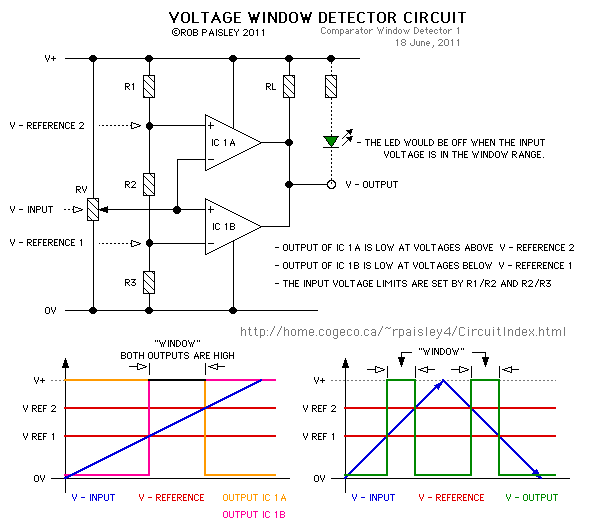

Diagram would be much better. (I want just one output to be active at time, coresponds with the selected input)
Something like this??? Dont know if it is right, or not.
Yes! that'll work, a window comparator that outputs a high if the input voltage is within range.

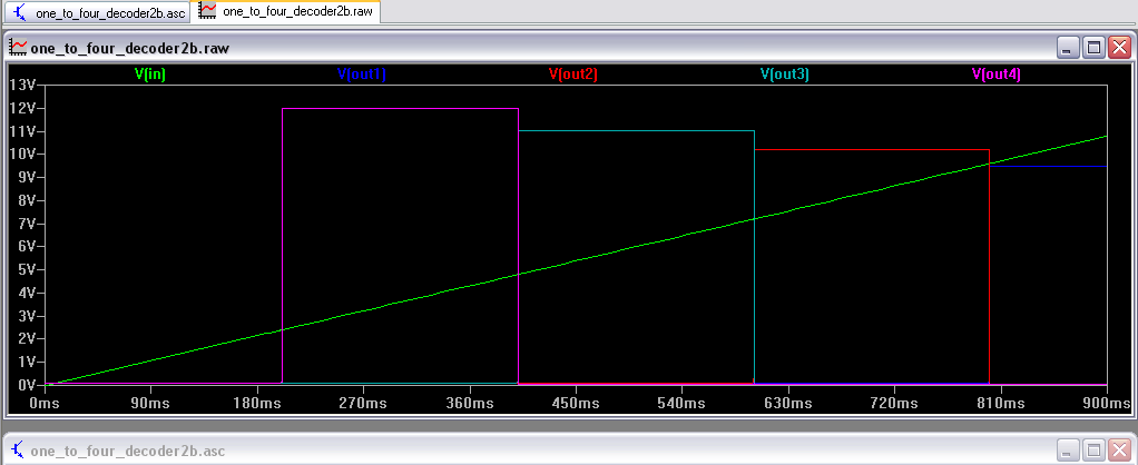

I came up with a quick one using 4 comparators, a few transistors and diodes. Essentially, its a 4 level comparator - the tough part is decoding the output so instead of it being 0001, 0011, 0111 and 1111, its 0001,0010,0100,1000. Mines a bit complicated..... and I drew it in LTspice, which is great for simulation of analogue, but not so clear for basic schematics, or digital stuff.
Thanks a lot....
- I need the output voltage the same as input = +12V
So which one do you consider most suitable for my needs?
does the windows comparator output voltage is the same as input? I need two comparators for each output, right? So I need 2 quad camp, for example LM239???
Yep, the LM239 should work. For each channel the schematic you posted would be fine. two comparators, and four transistors - not bad!

Do I ignore the RV, and instead of it the input would be mine Switch's output to IC1A negative and IC1B positive ???
the range is really set by R1/R2 and R2/R3 means what???
for example for the range app. from 480Ω to 600Ω, the R1, R2, R3 would be???
Yes, you can omit the RV, your input will go straight into both comparators. It will behave the same, as the inputs to each comparator are still connected together, the only difference is that instead of RV supplying a variable voltage, your switch is doing so.

Calculating the voltages at the points between R1 and R2, then at R2 and R3 just involves treating R1 and R2 as a single resistor - or treating R2 and R3 as a single resistor. SO say R1 = 5k, R2 = 8K, and R3 = 3k. R1 connected to GND< and R3 connected to VCC.
Total resistance = 5+8+3 = 15K. The voltage between R1 and R2 = VCC* (R1/(R1+R2+R3)). The voltage between R2 and R3 = VCC*(R1+R2)/(R1+R2+R3).
As you're usnig this for a 'window', it would be best to pick a specific voltage, or rather a fraction of your power supply voltage (12v) and then set your window above and below this. Example, 4V. The window is centred at 4V, but you want between 3V and 5V for a bit of space. So VCC = 12V. V1 - 3V, V2 = 5V. Now V1 is 3V, which is 25% of 12V (VCC) so you know that:
V1 = VCC (R1/(R1+R2+R3). -> 3 = 12 * (R1/(R1+R2+R3). Treat R2 + R3 as Rx. 3= 12*(R1/ R1+Rx). 1/4 = R1/(R1+Rx).
R1 = (R1+Rx)/4. - > 4*R1 = R1+ Rx. SO Rx = 3*R1. So, R2 + R3 must be 3 times the value of R1.
It all looks complicated, but its not really - you do'nt have to be too accurate, since you're only dealing with 4 voltage levels.
An easy way of creating references is to use a string of resistors of the same value. Example: 10k. If you have 5 resistors of 10K, then the total is 50K, with VCC across it. The voltage across the first resistor os 10k/50k = 1/5 = 20% of VCC. Next? 20k/50k = 2/5 = 40% of VCC, then 60% of VCC, then 80% etc... So this way you can create evenly spaced voltage references :)
As you want 4 outputs, and you have 12V supply, your windows should be centred at roughly, 12/(4+1) = 12/5. S0, 2.4V, 4.8V, 7.2V and 9.6V.

I knew it can be somehow calculated... made and formula
V1 and V2 is known
you set just R2
Voltage between R1 and R2 = V1 and voltage between R2 and R3 = V2
R1 = (R2+R3)*(V/V1-1)
R3 = R2*( (V/V1) / (V/V2-V/V1) )
took me some minutes, but made it :) i mean the formula....
