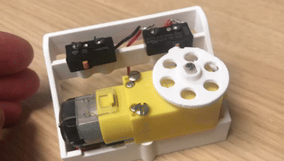

What would be the most basic circuit for controlling 1 revolution of a disk at the push of a button? As per below schematic, the disk turns CW until the marker meets a sensor. Then, with a single push/release of the button, the disk makes the next revolution. Etc.
Disk speed 60 rpm. Position accuracy is not required. Circuit power ±10W. Mechanical, optical, magnetic, etc. solutions are allowed.

Have you decided on the sensor, or is that part of the question?
This can be as simple as a SPST switch with NC (normally-closed) contacts. When a protrusion/extension/whatever on the wheel hits the switch, the contacts open and the motor stops. To start things, connect a SPST switch with NO (normally-open) contacts, like most simple pushbutton switches, in parallel with the sensor switch. Hold down the pushbutton long enough for the motor to move the disk off of the sensor switch.

I mean that it seems to perfectly meet your needs. That you took in a variety of ideas from members here and then laid out a proposed idea of how you are going to proceed. Then you built what you proposed and it works perfectly - meaning that it works perfectly for your needs.
I was just making fun of some other members who were criticizing your plan and trying to optimize it to the nth degree. I'm really happy that you didn't listen to them and built the thing and you seem satisfied with the results.
If you find a failure mode, wear surface or eventually need higher accuracy with the position of the off-state, at least you have a great start with your working model.
Good work and have a great weekend.
Does it start /stop with a useful load?
If it coasts past the cam bump, will it restart and keep going?
Otherwise, it works.

Any reason it has to start/stop with a "useful load"? I think not. If the OP is satisfied, then the project was successful - regardless of your specification for his project.
