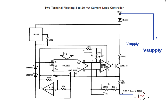

Hi all,
Does somebody have tried to build 4-20mA converter using IC DAC0832 (datasheet on page 20)...?
I have been build it but its not working. I was test the input data by SPST toggle switches to ground but the output always 18.9mA (single supply 12vdc 500ma) although switch has changed (0...255).
I could not find the 92PE37B transistor in my country so i changed to 2sc4408.
Could somebody help me, why is it not working...?
That's a floating circuit so do you have the switches going to the DAC common, not circuit ground?
I have connected the switches to pins 3 and 10 of the DAC. Is it your mean..?
I guess you know its a two wire system.??
You measure the 4 to 20mA in the low side of the "0"v [ 4-20ma] of the power supply to the project.??
Whats the voltage powering the circuit.?

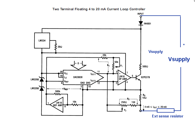

I put digital ampere meter instead of "ext sense resistor" to measure the 4 to 20mA. Supply is 12vdc 500ma for output 18.9mA. and
Supply is 16vdc 500ma for output 25.3mA.

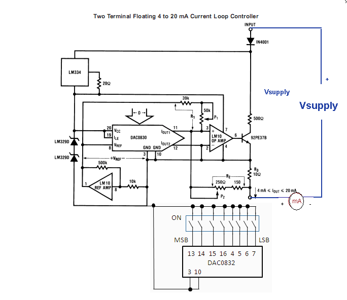

How are the DAC parallel inputs connected and what are they referenced too, ie: which ground.?
I just follow the schematic in the datasheets on page 20. parallel Input connect to pins 3 and 10 (gnd) when logic is low (switch close/on) and floating when switch open(off).
I know how to set the status of the parallel pins, what I am asking is which grounding point are you connecting the 0V of the select switches.

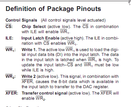

If you are using an external ground are you using the opto isolators as specified on page #20.?
Also how are you switching the Control pins of the DAC.?
Hi Eric,

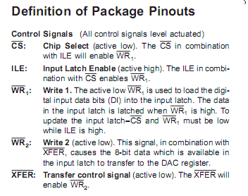

I make it low. CS(PIN1), WR1(PIN2), WR2(PIN18) and XFER(PIN17) are connected to ground of DAC (PIN3 & 10). I have replaced ic dac0832 with new one but the result still same ( output is 18.9mA).
Also how are you switching the Control pins of the DAC.?[/QUOTE]
How are you switching the Control pins of the DAC.? Write, CS and Xfer.??
Hi Eric,
You cannot just wire the control pins to fixed voltage levels, you must switch the control pins as described in the d/s in order to load/latch the data into the DAC input buffers.
You are shorting the output with out a load resistor. Use a load resistor in series with your ampmeter. Andy
