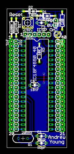

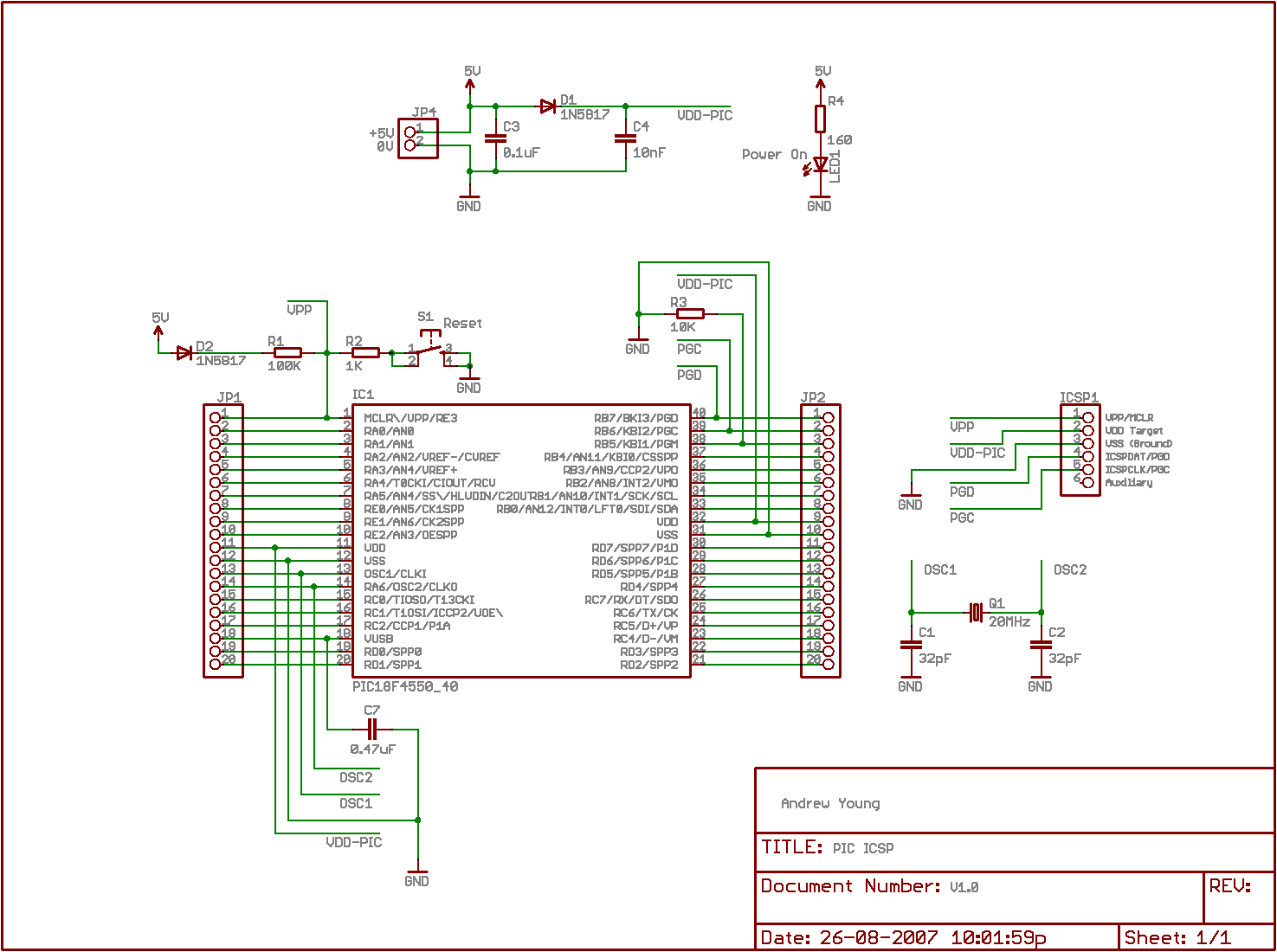

Hi everyone,
Well I usually work off of a breadboard or stripboard, but recently some of you may have noticed my post about wanting to start with making my own PCBs.
I've been making lots of PCB designs as practice and I thought I'd make this one - It might be useful to some people here.
It's designed for 40pin PICs. It *Should* be compatible with the PIC18F452 (Read on about C7 !!) and it is designed for the almighty PIC18F4550.
It is designed to go between the PIC and your breadboard in order to perform some of the standard tasks. (Reset, ICSP, Power LED, 20MHz Crystal)
C7 is optional for decoupling the 3.3V output on the PIC18F4550, therefore it is NOT needed on the PIC18F452, but it probably wouldn't cause any harm to leave it there.
It's designed with hand-soldering in mind and is able to be produced on a single sided board with only one jumper. (Although it would be a pain to solder the 2x 20pin headers on the solder side) Also note that there are two components which are designed to sit in the gap of the IC holder, underneath the PIC.
I'm also going to design a SMD version. ;)
I know there are probably boards which do these functions already, but this one might do things differently ? It's my little thanks for all the help you guys have given me recently.
Anyway, it's all attached in the Eagle format.
Suggestions, improvements, comments ?
Please note that this has not been tested.

You'll need a couple of 0.1uf decoupling caps on both VDD & VSS pairs, also since it's a 18F4550 with the VUSB cap adding a USB-B connector might be a good idea IMHO.
Would just adding a single 0.1uF capacitor next to the 10nF which is under the IC be fine ? Seems as adding two would just make it the same as a 0.2uF capacitor ? In the SMD version I'll make sure the capacitors get placed right next to the pins, one per pair. To be honest, I'm not using any capacitors except a 47uF a bit away from my PIC on the supply rail with no problems, so surly for testing pruoses they don't make much of a difference ? I'll be sure to add any that you suggest anyway - There's plenty of room in the IC socket. :)
The reasons why I didn't add a USB connector was because of:
1) I intended the circuit to work with more than just the PIC18F4550.
2) I run out of space, the board's height is the max allowed in the lite version of Eagle and the width is just thin enough to only take up one column in a standard breadboard.
However for the SMD version I will add one. I guess it can always be left off if a different PIC is being used.
Thanks for your suggestions.
Edit: I also think that the layout could be used to produce the board with this technique: http://elm-chan.org/docs/wire/wiring_e.html (For people who can't make PCBs)
The trick with bypass caps is trying to keep the as close as possible to the the ICs power pins. I didn't notice the 10nf under the PIC in your first post. Should do the trick fine. 0.1uf and 0.01uf caps are often similar in size and it's not to hard to pack a pair of them under the PIC.
PS some sockets have a center bar or bars.
Ah okay then. I'll be sure that the SMD version has caps as close as possible while still being solderable.
I designed it when I got a turned pin IC socket. (I normally use the cheap ones for stripboards, but I wanted one for my breadboard) It seems to have a lot of space under it as the turned pins seem to stand it off a little more. Also the center bars should be easy to cut out although I did design it with a socket in my hand so the components under the socket *should* fit nicely in the gaps - Don't hold me to that though. :eek:

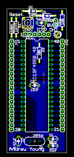

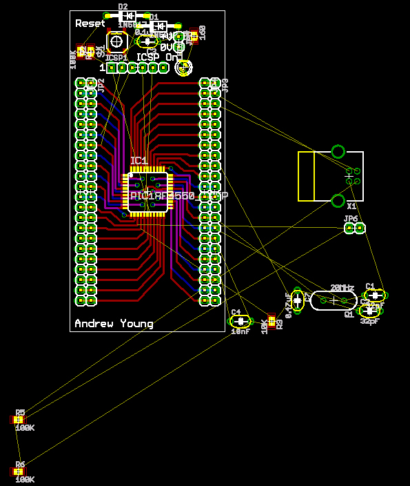

New version. I had a go at making the SMD version, but the problem is that there isn't enough space to convert the SMD IC into a DIL pinout. (First pic) There was no space to run any more tracks, nevermind placing components.
Anyhow, V1.1 has lost the capacitor for VUSB. It has however gained an extra set of headers. (Green is my colour for bottom-side silk screen) It's also slightly shorter due to the loss of the capacitor.
The next board that I'll make will sit on top of this and will have the capacitor and socket for the USB. It will also allow RB4 to be used as a VBus sense. Finally it will have another power LED, a 7805 regulator (With power jack) and another reset switch. It might get a power switch too. If I have the space, I'll see about adding a COM port.
C&C ?
