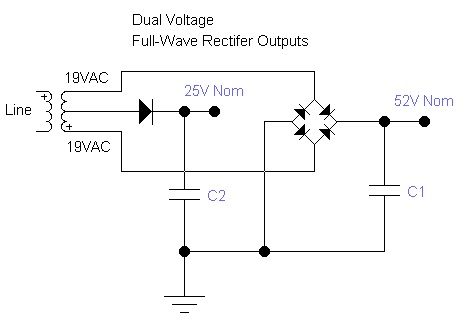

The **broken link removed** has an operating voltage range of 28.0V to 53.0V, but I'd still like to regulate it to 48 if I can.
According to the datasheet you linked, it's good for up to 56V.
Is 38V across both secondariness the measured voltage or the voltage rating?
If it's the voltage rating then you're sensible regulating because the voltage will be 10% to 20% higher under light loads.
If it's the measured voltage then a regulator is probably not needed.
If I'm understanding things correctly... would I use R1=240Ω and R2=9KΩ with the ~50V input to get a regulated 48V out?
The input needs to be 3V> than the output to ensure good regulation.
The diodes will drop 1.4V
38√2 = 53.74V - 1.4 = 52.34.
The minimum input voltage for the regulator to regulate properly is:
52.34 - 3 = 49.34V
The maximum allowable ripple on the filter capacitor is:
49.34 - 48 = 1.34V

I assume I should connect the grounds post-rectification (that is, connect on the DC side of things) right?
Yes.
