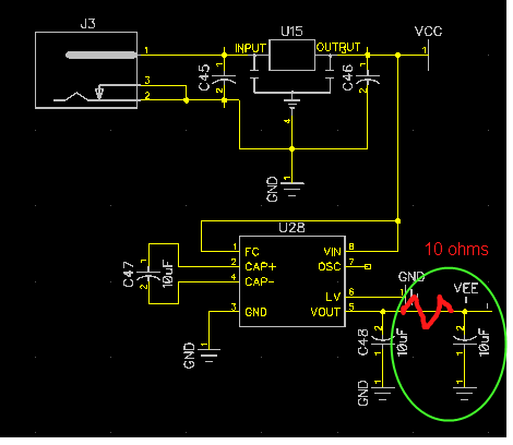

In the green circle is the RC filter. If the ESR of the cap on the right is large the filter will not function well. What Tony said.
I do not see capacitors on the power supply of the op-amps.

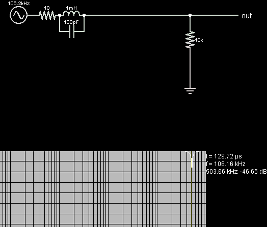

If you found that the voltage drop across the 100 ohm resister value that I suggested in the filter too great you could try an inductor. That way you would have a high reactance at 80 Khz but a low resistance at DC. A 1mH inductor would have a reactance of about 500 ohms at 80Khz

Thanks Ron, I didn't set up the RC properly as I used the existing CAP and didn't add a new one. So to understand what I need here, something like this?

If I used your suggested values of 10Ω resistor and 10uF capacitor for the RC, the cutoff would be at 1.5KHz, which I assume since this is suppose to be -5VDC, the lower the cutoff the better?

If you used a 1mH choke instead of 10 OHms it would appear as 250 Ohms at 40kHz and suppress noise /25 or double at 80kHz
I don't know what cap you are using but from the data sheet I think it has 2 ohm of ESR.
So if you added a 1 ohm resistor and are using a 2 ohm cap then at high frequencies you have a 1 to 2 ohm divider. So the noise will not be down much. (2/3) So you need to make the 1 ohm bigger and/or reduce the ESR to get a 10: reduction or 100:1 reduction in noise.

Ron, I actually used **broken link removed** for c48, the one I just linked in the previous post was what I found when I searched for low ESR capacitors. I really have no idea how to determine a capacitors ESR if it is not spelled out in the datasheet (which it doesn't appear to be in this case). I understand what your saying about the ratio, I really need to know my CAPS ESR to determine if it is even in an acceptable range so I don't have to bump the resistor value too high. I think I'll go check to see if I can dig up an inductor @ 1mH as recommended by Les, yourself and Tony and see if that makes a difference.

I have just realised that there was a flaw in the way I suggested doing the tests yesterday to see if the noise was finding its way to the op amps via the +5 or -5V rails. When I suggested re connecting the +5 supply to the input of the max660 I should have also said to load the output of the MAX660 to the same current as that taken by the negative supply to the op amps. With load on its output the pulse current on the input will be larger so it will probably put more noise on the +5V rail. So it is still possible some noise from the +5 V rail is causing the problem when the MAX660 output is loaded.

So results are in, I added the inductor capacitor filter between the output of the MAX660 and the -5V plane and the 40KHz signal has been neutralized. I still have the 500KHz signal present but it is minimal in comparison to the noise present before. I could always add the LC filter to each line if I wanted to refine THIS design more.

Update: I am doing a second revision of this board and I've cleaned up a lot of mistakes from the first. I am going to use the low ESR capacitors as recommended from the MAX660 datasheet like you all have mentioned this entire time. I'm not sure why I didn't notice how important the ESR of the caps was before as it is spelled out clearly in the datasheet,
"To reduce the output ripple caused by the charge pump, increase the reservoir capacitor C2 and/or reduce its ESR. Also, the reservoir capacitor must have low ESR if filtering high-frequency noise at the output is important."
