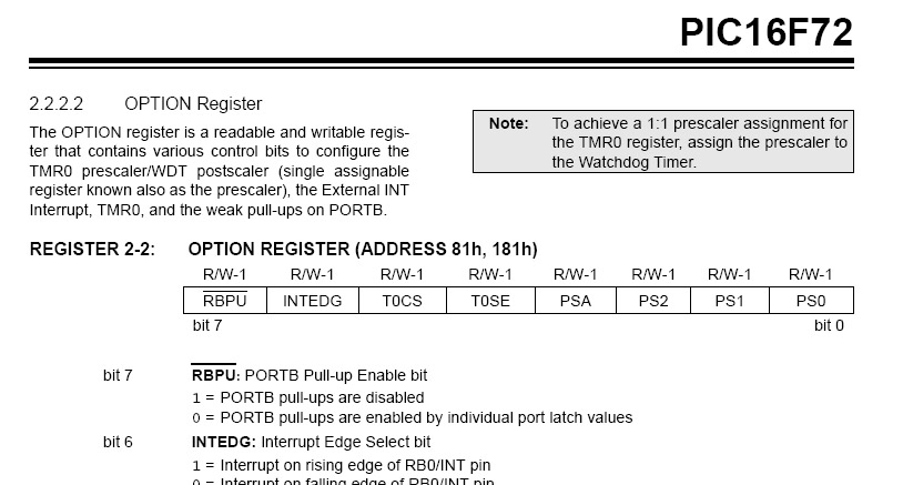

But doesn't setting the weak pull ups, pull-up the inputs to give them a high logic level?
Then on a keypress because the outputs are low, the input goes low, and theres your change.
Please correct me if im wrong here.

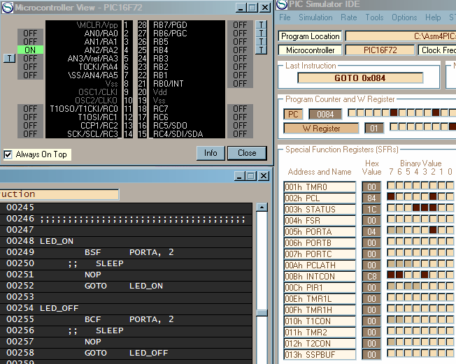

The Oshonsoft is showing them as low.??? I will look futher
clearing bit 7 off the option reg is supose to turn pull ups on

Still doesn't work. On power up the LED come one and stays on.
Just making sure we have the same code here::

Thanks Eric.
It seems fairly straight forward doesn't it.
1 LED
1 Keypad.
press key light goes on.
press key light goes off.
And SLEEPing in between with an interrupt to wake it up.
It will be the smallest little thing thats F ing the whole code up.
hi jakes,
Look at the state of the PORTB pins on the sim,[ see image] all pins are low, so the keypress will not be detected, so the ISR will never be called.
If a add a line of code enabling the PORTB output pins I can cause an ISR call when a key is pressed.??
Ok.
I can understand that.
But why shouldn't they be low.
The Weak Pull-ups are holding the 4 inputs high (RB4,5,6&7),
So if PORTB (RB0,1,2&3) are all low, when a key is pressed, one of the inputs will change from high to low.
Wont it?
and wont that trigger the interrupt?
once again please correct me if im wrong, or you mean something else.

hi Jakes,
Checking the keyscan ISR shows it will bever give the correct keycode even when called.
For test, by adding the ;+++ I can get the ISR called from a keypress, but the keyscan code dosnt work correctly, where is the code from.?
	MOVLW   0x0f;++++++++
        MOVWF   PORTB;+++++++++
        SWAPF   STATUS_TEMP, W
        MOVWF   STATUS
        SWAPF   W_TEMP, F
        SWAPF   W_TEMP, W
        RETFIE

hi Jakes,
That last code you have just posted is the one I was using.
As I said earlier for some reason the 'weak pu' appear to be not working as one would expect.
The keypad pins PB3 > 0 are held low , so that a change on PB7 > 4 isnt seen by the program so the interrupt is never called.
The two lines I added force the PB3 > 0 lines high, so that when a key is pressed the ISR is called OK.
The ISR sub then sets each row in turn low and tests for the keycode, but in your code the key test feature dosn't work correctly.
For ref only look at this pdf.
  • 00566b.pdf
Ok, whats wrong with it?
The pullup feature dosnt appear to work in Oshonsoft, I will have to confirm this.?
