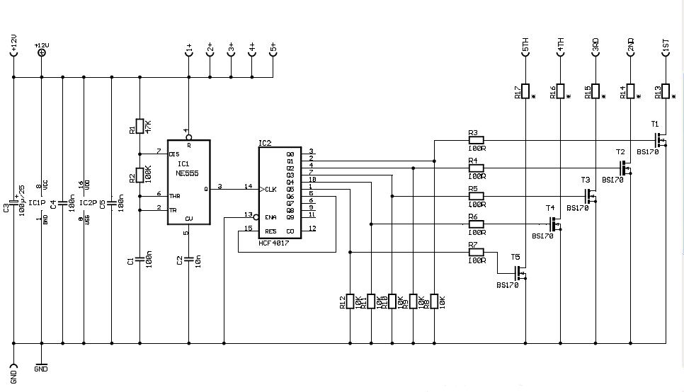

Hi there, I'm new to this forum and am having a bit of trouble with a project.
I'm making custom LED tail lights for my car, and I need help with making a scrolling indicator. I know how to wire up basic leds with resistors, but unfortunately didn't pay much attention in highschool as to how transistors/timing circuits etc work.
This is a simple animation of what I am looking to accomplish with your help.
I need each "arrow" to be a 12v channel, I've worked out that I need a 14 ohm resistor for each channel (so closest actual resistor is...16 ohm?
It's probably such a simple request, but I've tried looking all over the net, I've found similar circuits and they said you could modify the channels with transistors but, I'm not that good with electronics.
Any help would be greatly appreciated! :D
It looks like it would help, although I honestly don't understand half of the stuff it is talking about. I understand when its talking about "grouping" the LED's through gates but thats about the limit for me haha. It said on the page that it can run higher current loads...is there any way to tell if it can run 12v per output or if you can use selective outputs (eg instead of it running through all 10 it only runs through 5)?
You can short-cycle the 4017 counter by feeding back the first unused output to the Reset pin. For example, if you want only five leds, you would used the decoded OUTPUTs 0,1,2,3, and 4. Output 5 would get wired back to RESET, so the counter recycles back to OUT0 after OUT4 (five states).
Note that the 4017 will barely drive one 20mA LED per OUT pin. For your application, you probably need >100mA per arrow segment, so you will need a driver consisting of a transistor (or something else) between the 4017 pin and the clump of LEDs in the segment.
According to the 4017's datasheet it will run on 12v which is a plus for you, but Im with Mike about needing a driver for your LEDs. I would recommend using a FET instead of a transistor for switching your load, with a similar circuit as this (replacing the LED in the circuit with your cluster of LEDs, and the switch with the decade counter):

The circuit you described, is that basically (from what i understand, remember I'm a complete novice at this) the output pin on the decade counter serves as a switch to a separate 12v circuit (your circuit) for each "arrow"? Also, in the circuit, if I was connecting this to each output pin..would I need a diode, seen as its got a power supply on it?

Each segment of an arrow uses an output from the CD4017 which drives its own Mosfet.

I still don't understand how a mosfet/transistor works.. I know it's a gate of some sort, I believe it is anyway, and how do i know what type of mosfet i need?
The Mosfet in the schematic is an N-channel one (not a P-channel one). It must be able to conduct as much or more current that is needed for the LEDs.
Most N-channel Mosfets turn on completely when the gate is 10V (to 20V) more positive that the source which is grounded in the schematic. The Mosfet turns off when its gate voltage goes to near ground.

Here is a circuit suiting your needs.
IC1 (NE555) is an astable multivibrator oscillating at approximately 60Hz (58Hz). It clocks the counter IC2 (HCF4017) which is a decade counter (Johnson counter).
Outputs 2 through 6 switch on the N-channel MosFet transistors which in turn switch on the connected LED chains. When the counter reaches count 7 it resets automatically and restarts the sequence.
The BS170 has an On-resistance of 1.2Ω which you should consider when calculating R13 through R17 for the LEDs you are going to use. The transistors can handle currents up to 500mA which is safe for an LED chain of normally 20mA.

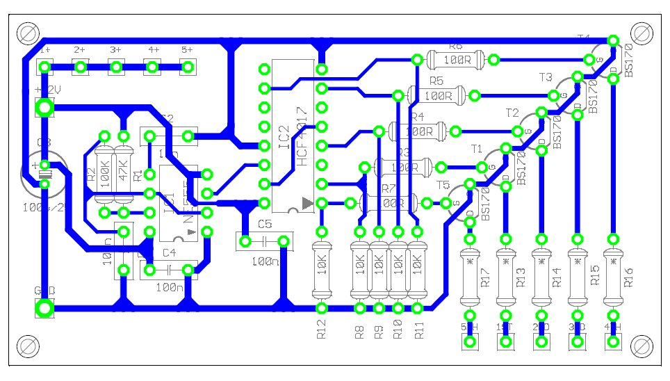

Boncuk, what is the purpose of the 100Ω resistors at the gate of the MOSFETs?
Mosfets ring or oscillate at a VHF frequency which makes them very hot if they do not have a low value resistor (10 to 100 ohms) in series with the gate mounted very close to the gate pin.

Thanks heaps Boncuk! Do you have this file in Protel, Altium, Eagle or Gerber format? I need one of these to get it manufactured. Thanks heaps! I'll be sure to update you on the project as it comes, all of you, so you can see what your help turns into!

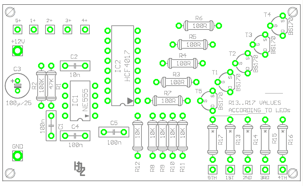

Hi individual,
I will provide Eagle files for you. Just PM me your email address. (Download Eagle for your OS from CadSoft Online: EAGLE Layout Editor)
When taking a close look at the PCB layout I guess it can be shortened by at least 15mm when placing parts a bit closer. :)
I'll rework the design leaving it purely single sided.
Here is the altered design. Attachment shows the silk screen. Board size is now 75.5650X44.7675mm (2.9750X1.7625").
Regards
Boncuk
