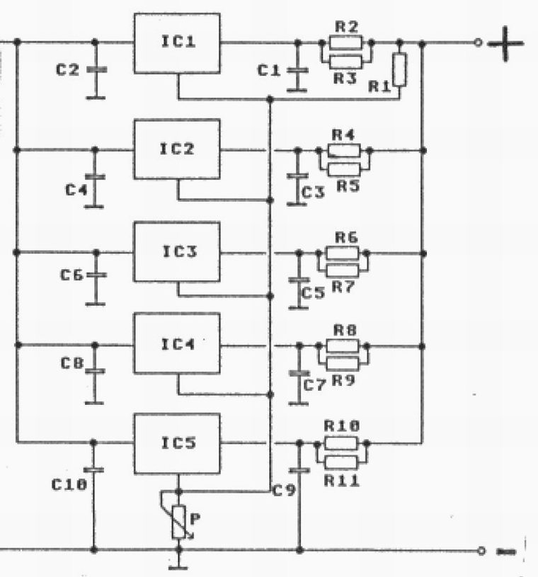

5 x LM338K
moutouloss
If I put 5 x LM338K (5A) parallel (like the circuit), I will have 25A power supply :?: :?:

yes, you should be okay to parallel them like that since the schematic shows the use of series resistors on the output of each regulator. That keeps the regulators (which will all try to keep the output at slightly different voltage levels) from fighting each other, which would cause one of them to take far more current than the rest and blow itself up. however, it does require lots of bulky power resistors, and they are going to be wasting power as heat, so you will be reducing the already not-so-great efficiency of linear regulators... but if you don't care about the efficiency, and can handle the heat generated, it should work for you...
In his other post he showed a 40V input and an adjustable output voltage from 0V to 30V @ 25A.
The LM338's minimum output voltage is 1.25V and at 25A the regulators must dissipate 194W each! You would be lucky if they could dissipate 50W each.
A switching voltage regulator is needed.

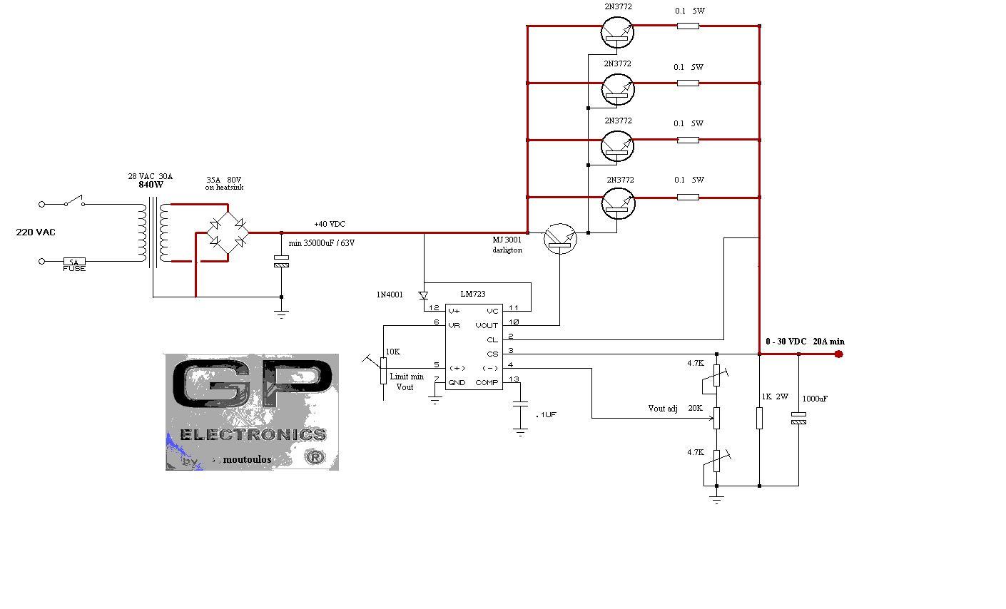

You posted the schematic of a PSU that you said burned when its output was shorted. You claimed that it was rated at 0V-30V at 20A. But on another post you said you were using a 13.8V PSU for testing high-power car amplifiers and it didn't even get hot. Maybe it was this PSU, but probably hardly ever at its full 20A output.
I explained to you that it was the 800W of heat that burned the PSU when its output was shorted.
Then you asked if LM338K regulators could replace the power transistors in the original PSU. Then you asked the same question here, and some people here didn't realise that they would dissipate power way more than their rating, just like the transistors tried to do.
Actually, the LM338 is smart.
In your circuit with its 40V input, if the regulated output voltage is 10V or less, the LM338's will have 30V or more across them and their datasheet guarantees that they will reduce their output current to no more than 1A each to protect themselves.
They are also smart because they shut-down when they get too hot. :lol:

Don't confused, I using this power supply (with LM723 - 2N3772) like bench (laboratory) to test several circuit (0-30V), and the same power supply for test in audio amplifiers (after repair) in 12-13.8V if it is function well.
With LM338K is a different construction, and I want to made it for second power supply. I don't say it to replace power transistor (with LM338K).

I hope you understand why the transistors burned in the lab supply when its output was shorted or if its output voltage is less than about 25V at 20A, or if its output voltage is set low with an output current more than about 7.7A. When the transistors are replaced with new ones, I hope you understand that they will burn again.
In the supply that you plan to use LM338K paralleled regulators, I hope you understand why they reduce their output current with more than only 10V across them.
