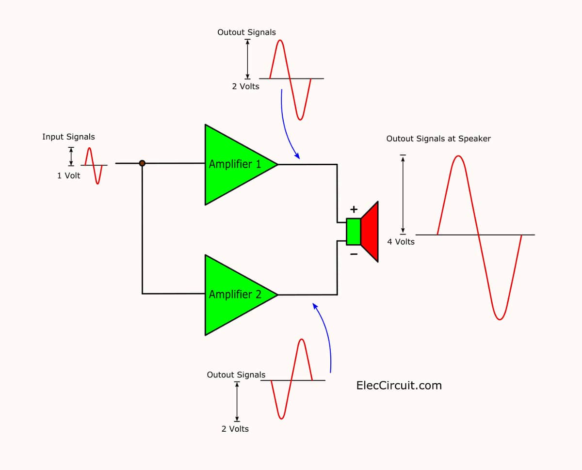

In case Piezo not loud enough at low battery V remember a bridge drive approach of it
which yields up to 4X the power of a single ended drive, due to voltage doubling :
Due to P = E^2 / R
Caution, Piezo's have a limit of Vdrive before mechanical fracture, so specs matter.
Also : https://electronics.stackexchange.c...de-in-this-driver-connected-to-a-piezo-buzzer
Lastly note you rarely ever get 4X because driving sources not true V sources, their
loads compromise swing.
Regards, Dana.

he doesn't have a simple piezo - he has a buzzer module that works on 3v DC
All the more reason to consider, if design sound level not great enough, especially
considering its a 3V design, to consider the bare Piezo.....but he is also space limited,
although you can get tiny logic buffer parts in very small packages to aid in this
approach.
Regards, Dana.
