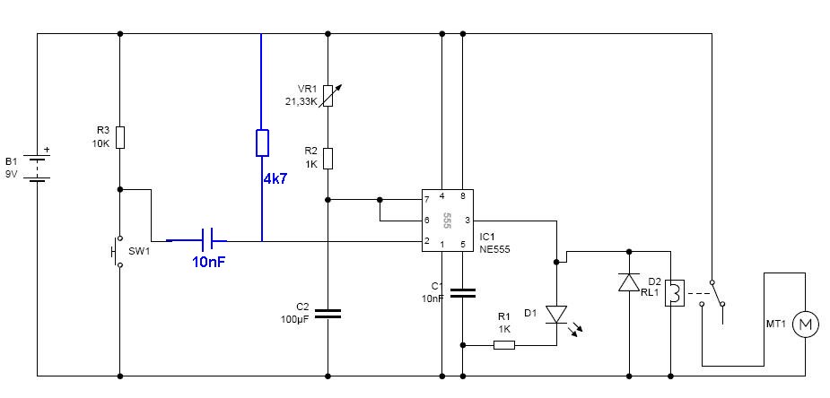

I'm planning to build a relay timer with a 555 in monostable mode. I'm aiming at a pulse of 3-15 seconds, even if the trigger switch is kept on for 5-10 minutes.
I have not been able to find descriptions of a way to keep the timer from going continuously, such as the circuit in the attached diagram does.

Look at this mod of your circuit.
You can make the mono trigger at power up, but to power down after a few secs will require extra components

Thank you very much Eric, that was an amazingly fast answer!
At first i didn't get it to work, but i think the components you added on the attachment got mixed up. I put in a 47uF cap, and a 10K R, and it works like a charm!

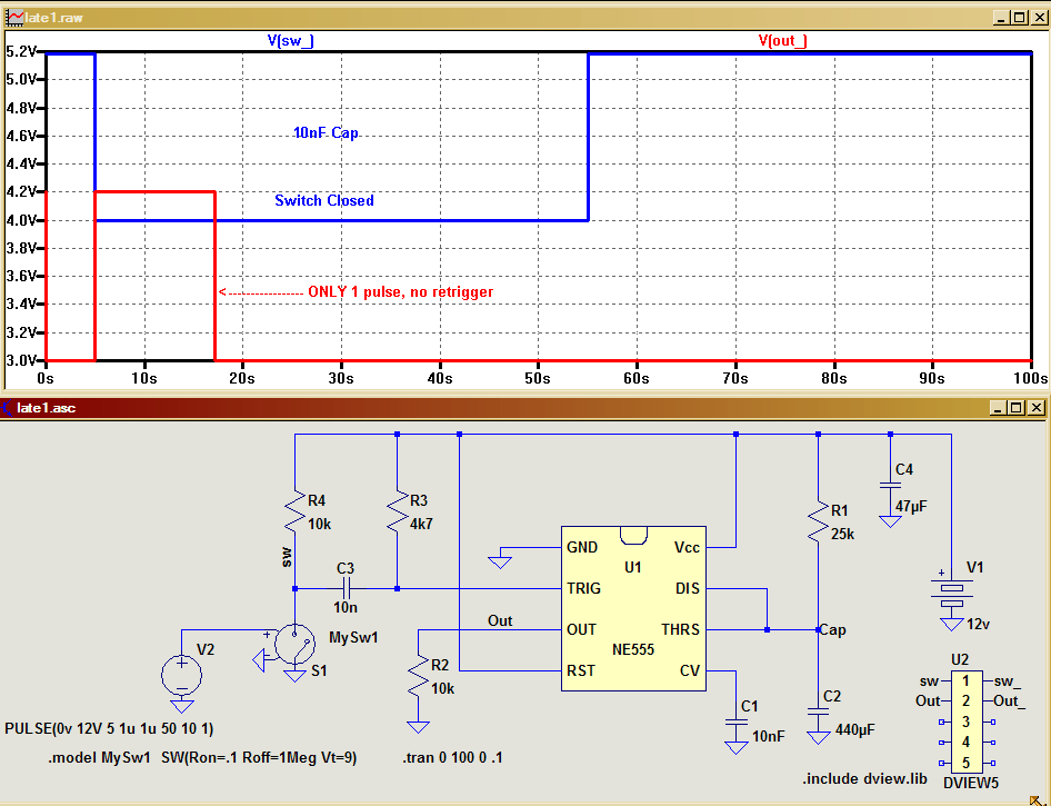

hi Lade,
I am puzzled why you need a 47microFarad trig capacitor.?
It works fine with a10nF.

OK it works with the 10 nF cap now!! I don't know what went wrong before.....

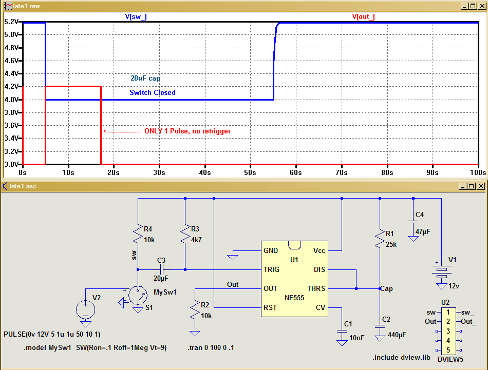

Still issues with the monostable 555....
Well..... I have made the circuit attached here , and it works fine. It's made on veroboard, and it's not pretty, but then again, it's my first! I'll have to do another one with better layout etc.
But in the part you suggested (cancelling continous triggering), i cannot get it to work if the capacitor is less than 20 µF. I don't get it....
Is the 47µF electrolytic cap. across the power source necessary, or should it be omitted?
Thanks,
Lasse

Run tests with 20uF and 10nF no difference in re-trigger, single pulse only while switch is closed.
EDIT:
Rechecking your circuit, you have not drawn in the base resistor pin3 of the 555 to the transistor.???
Also you should have a 100nF cap,across the 47uF, its possible that 'electrical noise' from the relay circuit is retriggering the mono.

I have not made the actual circuit with a 10nF cap, only the 20 uF shown in the schematics. When i run a simulation it still does not work.... The only thing left i can imagine is something in Circuit Wizard going wrong. I'll make the actual circuit as soon as i get time.

It works!
OK i tried to build the circuit and it works just fine!! Seems to be a bug in Circuit Wizard
I figured I would save time by simulating before building.... Yeah, right.
But I did get your other points and will use them in the new build.... And I guess I have learned alot more than i would if it had just worked right away. Always look at the bright side, eh?
