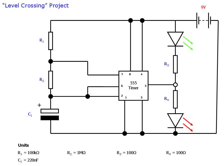

I'm new to electronics and I'm currently trying to use a 555 timer IC to make two LEDs flash on and off alternately (I later discovered that this has already been dubbed "the level crossing problem"). The circuit that I am using is attached.
However, I have run into the problem that I don't have any electrolytic capacitors, so I decided to try replacing C1 (in the circuit diagram) with a 220nF ceramic capacitor (and hoping that it wouldn't make a significant difference). I have built the circuits using a breadboard, and when I connect the battery, both LEDs light up simultaneously rather than flashing between the two.
Firstly, is this what would be expected if C1 were replaced a ceramic capacitor, or have I made a mistake while wiring the circuits?
Secondly, could someone explain why C1 needs to be a polarised capacitor, and how/why a non-polarised capacitor would behave differently?
Thanks in advance for any help

The capacitor has nothing to do with your problem. A non-polarized capacitor will operate the same as a polarized in this circuit. The only reason a capacitor polarity is shown is when you do use a polarized cap.
But its quite apparent why both LEDs light. You have them connected in series directly across the power supply without any resistors. You are lucky you didn't blow the LEDs (I'm sure you've heard somewhere that LEDs need a resistor in series with them to limit the current (??)). The high resistance of the 9V battery is probably what saved you.
For the circuit to operate properly you need a resistor of the proper value in series with each LED to limit it's current to the desired value. Connect them in the following fashion with the 555 output connected to the junction of the top LED resistor and the bottom LED:
(V+)---LED---Resistor-|-LED---Resistor---(V-)
555 Out------------ --|
The 2 LED's provide the path of least resistance to ground for the 9V from the battery. Instead of current going through the 100K and 1Meg resistors and turning the 555 on, current just flows through the two LED's to ground.
The LED's should light up when power is supplied and there is no oscillation, just 2 LED's that stay on.
This circuit is not set up right for what you're trying to do.

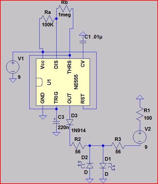

Try this instead:
If you use a second battery, then you don't interrupt the 555 circuit.

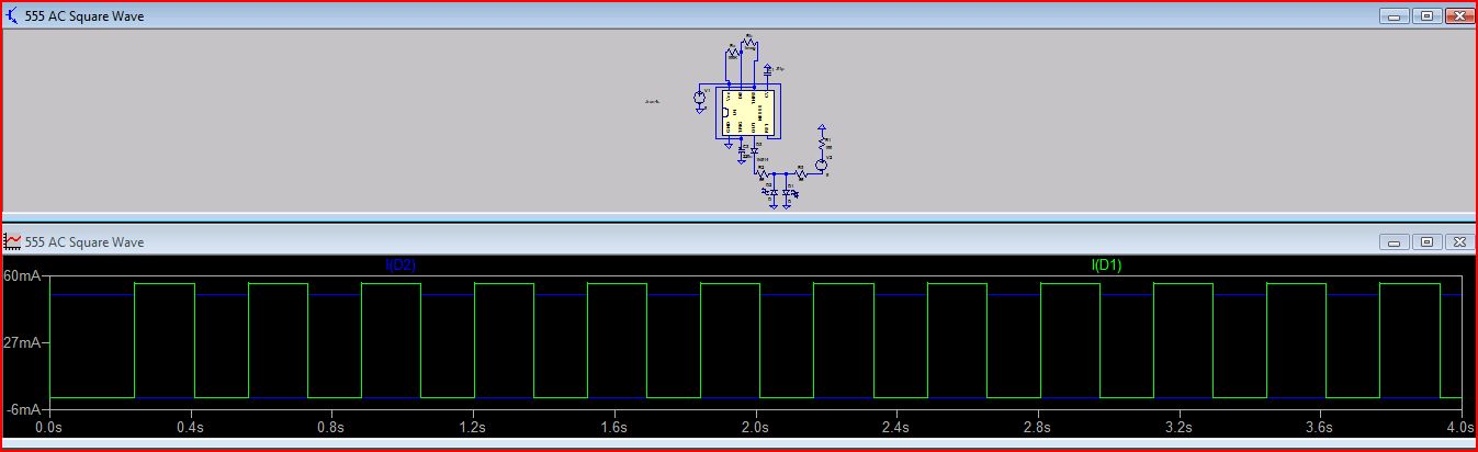

Here is what your results should look like if you put this together:
One of the square waves corresponds to the current flowing through one LED, the other square wave corresponds to the current flowing through the other LED.
Just get one more 56 ohm resistor, a 100 ohm resistor, a diode, another 9V battery, and the capacitor at pin 5 isn't necessary so you can skip that. Try it out and let me know how it works out.

The LED next to ground is on 99% of the time
Nope, just 73.3% of the time
t1/t1+t2 = R1+R2/R1+2*R2 = 68+39/68+78 = .7328...
I've tested it. You can clearly see two LED's flashing.
PS, the frequecy should be about 10Hz.
1/.693*1uf*(68K+2*39K) = 9.88Hz.

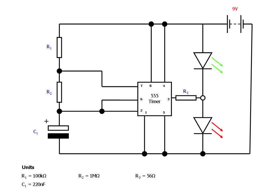

I've modified modified my circuit now, it now looks more like the diagram attached; but now the green LED (connected to the battery's positive terminal) is always on and the red LED is always off. That seems to suggest that the output of the 555 is remaining at 0V.
Any ideas where I might be going wrong this time?

The circuit is correct. You have a wiring mistake or the chip is damaged or a component is not connected. If you are using a "solderless breadboard, start again and re-wire everything. Make sure the resistors are in the correct places.
1. If you have a very high impedance meter, measure the voltage on the top of the 220n.
2. Replace the 220n with 1u to 10u and replace the 1M with 47k to 220k.
3. Replace the 555.
I heard "start again and re-wire everything" and my heart just sank to my knees I don't have a capacitor larger than 220nF, that's why I'm using that. I calculated (correctly, I hope) that the LEDs should alternate at about 3Hz though, which should be fine. I'll try rewiring the circuits...
It's up to you, but I am just giving you ideas that will make it 100% guaranteed that you will find the fault.
It could be a faulty connection or a short between wires or even a fault in a solderless breadboard. I have no idea.
But you have to do something that will guarantee the circuit will work.

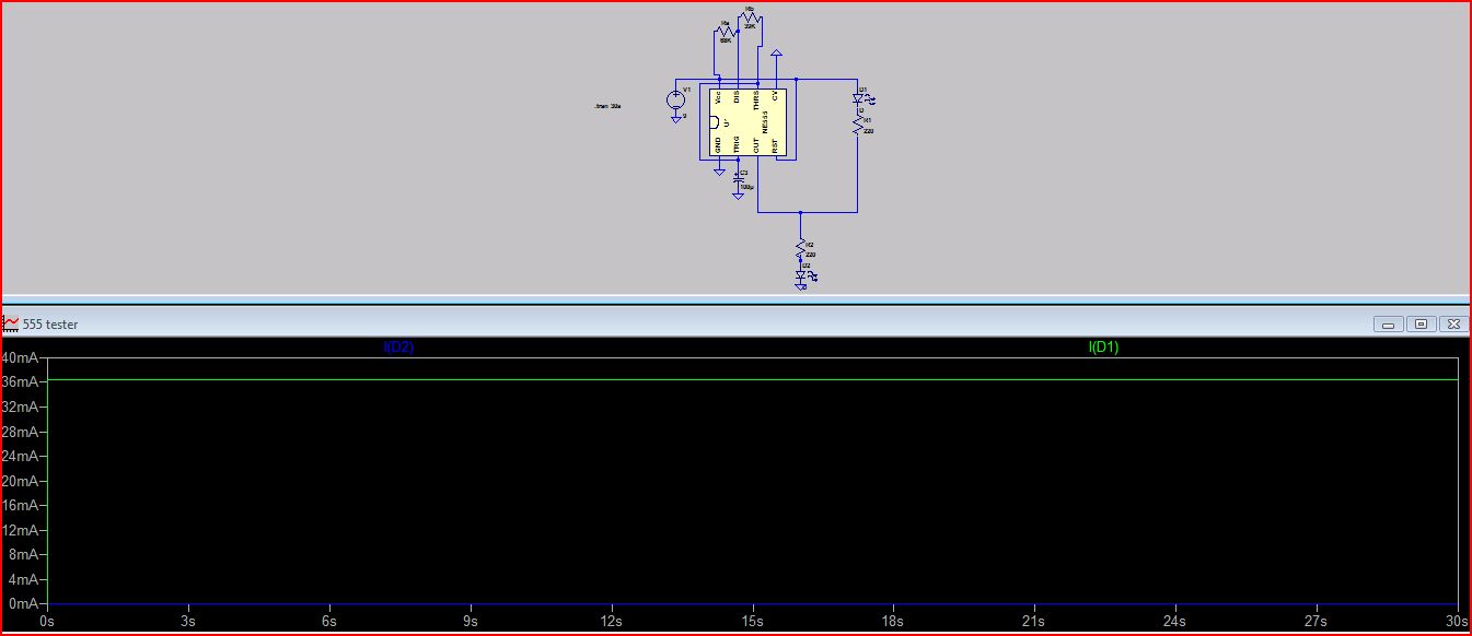

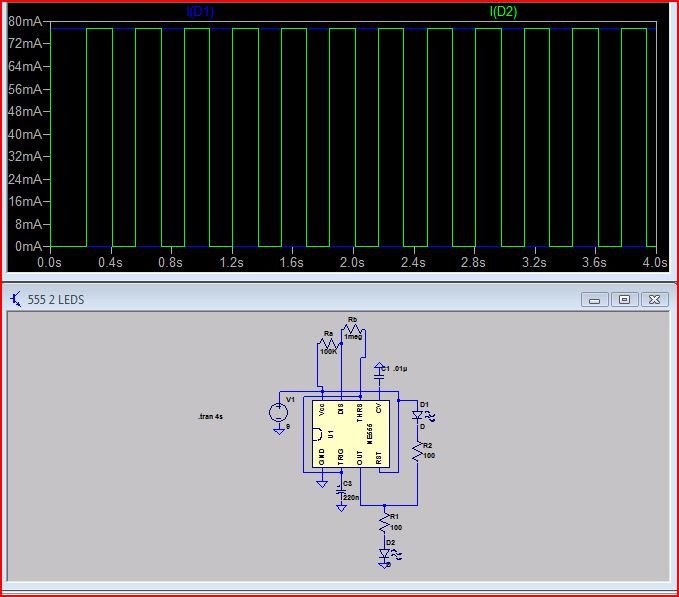

No capacitor at pin 5:
With a cap at pin 5:
Besides providing a straight path to ground through the LEDs, the problem with the first schematic you provided was that the LED next to the 9v battery would never have a chance to turn off unless the voltage at pin 3 was greater than or equal to the 9 volts from the battery.
With the 2 resistors though, you've now fixed that problem with a voltage divider.
