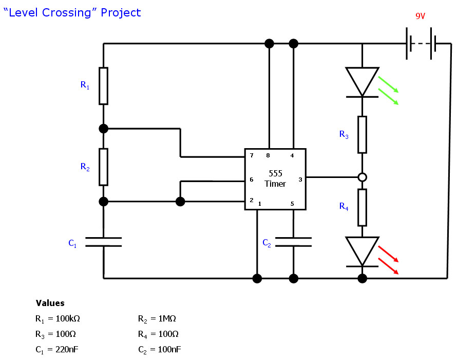

Yay! I don't know what I did differently, but I rewired the whole thing again, as well as including the capacitor between pin 5 and the negative terminal, and now the circuit works, and seems to alternate at approximately 3Hz as I expected. Thanks for all the help guys.
I've included the final circuit diagram just in case it helps anyone else who is new to electronics and working with 555 timers.

Congratulations. I think the problem you were running into was that pin 5 was grounded instead of not connected to anything (like Hayato pointed out).
I looked at the details of what most of the pins is used for, but I'm not sure if I found out what pin 5 is for. I believe the information I read said that it was used to set a new "threshold" value: could it be then that connecting it to 0V meant that the threshold was set to 0V, and the voltage was never below 0V so the output remained low? But if that is the case, why does inserting a 100nF capacitor solve the problem?

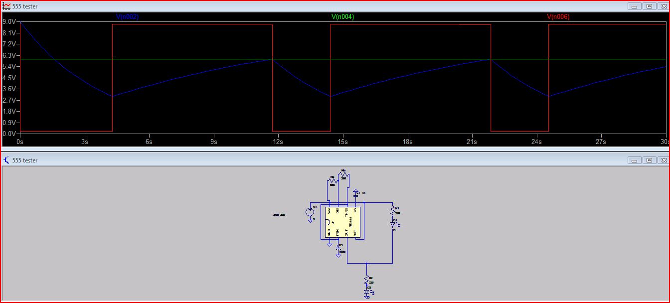

There are 6 volts (2/3 Vcc) at pin 5 with your current setup using a 9 volt battery. The blue line is the voltage drop of the capacitor at pin 2:
As you can see, the pin 2 capacitor charges and discharges between 3 and 6 volts, using the upper comparator voltage at pin 5 for comparison. When the pin 2 capacitor charges to 6 volts, the output at pin 3 is set to off and the capacitor discharges. When the pin 2 capacitor discharges to 3 volts, the output at pin 3 is set to on and the capacitor recharges.
Since there is a steady 6 volts at pin 5, the low value capacitor at pin 5 quickly charges and then acts as an open, similar to leaving pin 5 unconnected. If you leave pin 5 connected to ground, current takes the path of least resistance and you get no output at pin 3.
edit: pin 5 is the upper comparator voltage, so if you ground it then that sets the upper voltage to 0.
