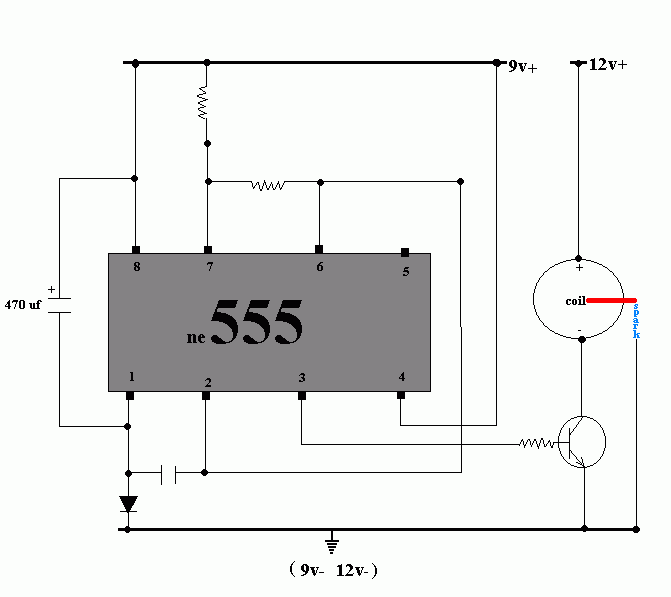

ive made the timer circuit and it makes an led flash ..right....well if i replace the led with a transistorand then place the led before the collector the led no longer flashes....it just stays on constantly....
i was using a led to test before i use the coil!
any ideas?

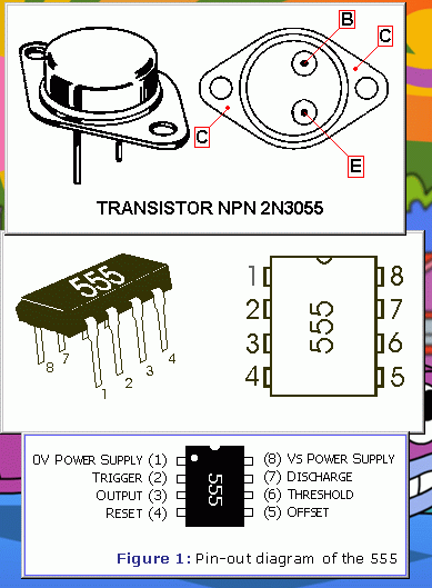

here Kev.
pin 3 of 555 timer goes to "b"(binary input of transistor).
"c"of transistor goes to coil.
"e" of transistor goes to earth.
I can't make it any easier than that.

For better understanding of what you are doing....
You are replacing the coil first with an led and it worked fine, and it should.
Then 2nd you replaced the led with another transistor and placed the led on the collector side of the transistor. This would make 2 transistors, right?
If this is correct my question then is this where are you connecting the base "B" side of this new transistor?
Think of the transistor as a switch completeley "on" or completeley "off". This is controlled by the current flowing through the base,oh and to some degree beta. It sounds like the current flowing through the base is keeping the transistor completeley on, which is keeping your led constantly on.
not quite ...seems i didnt explain it clearly ....i had an led connected straight to the output of the 555 and then replaced this led with the transistor and put the led across the collector!
kane2002
Aaaah, ok that is better. Does the LED dim at all or is constantly the same brightness?

it is still the same brightness ....which i thought was strange
but if i up the voltage then the LED jus dims (not flashing - prob because too much and so overloading LED)
