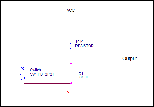

Here's the latest. I think the problem is in the switch and I can't get the debounce to work.
I only have a VOM but of course can check voltage levels
The way I get the counter to work is by triggering a 555 with a wire from Ground to the 555 trigger input. The 555 is set up
as a monostable timer. The 555 output goes to the counter clock input. If I touch the trigger wire to ground (count 1), wait for the 555 to time out then touch the wire to ground again (count 2) etc I cn get the counter to count. If I connect the counter Enable to the count I want to stop at it will stop at that cound.
I can't reliably repeat this sequence if I us a switch connect to ground to trigger the 555 and as I said attempts to debounce don't work.
Talk to you at 1:00
Regards,
Richard
I assume you have tried some switch debounce? Something similar to the attached?
The problem is that when a circuit like the attached will not overcome the switch bounce then we get into adding a schmidt trigger IC and the parts count starts to grow.
I will make every effort to be around my desk this afternoon. Hopefully no meeting or other things will surface. If I do miss you just leave a voicemail and I'll get right back to you.
Ron
