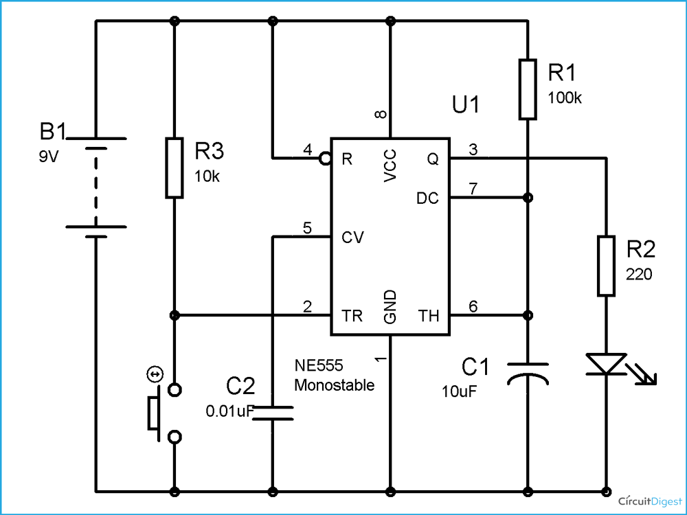

The circuit and the design equation are on this page:
Pin 3 connects to the output device. If you change to a CMOS 555 (LMC555, etc.), it will drive a FET correctly with no additional parts. If you go with a bipolar 555, an additional resistor and small zener diode are needed to guarantee turn-off.
ak
I wired up the circuit above and on pin 3 of the 555 timer I get power only when the pushbutton is depressed. let go of the switch and no voltage on pin 3
Checked wiring and its correct.

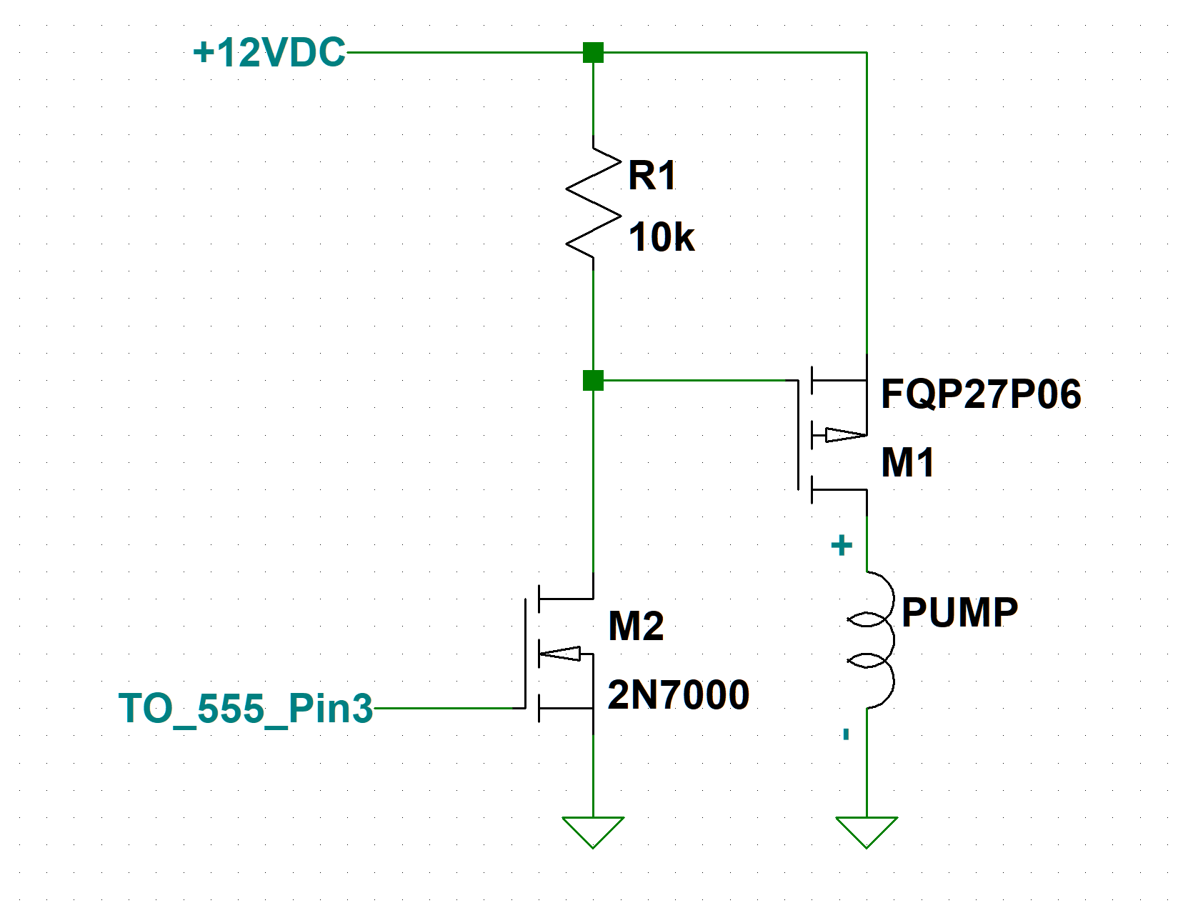

I'm under the assumption that when using the p channel (FQP27P06) that I have to apply neg voltage to the gate for the circuit to turn on (switching the positive side)
Even if the timer was to stay on. Pin 3 is positive
What values did you use for R1 and C1.
Sounds like they may be too small.
Use an NPN or NMOS transistor to switch the PMOS transistor on/off.
Like this:
Might also need a 1N4007 diode from pump+ to ground.
