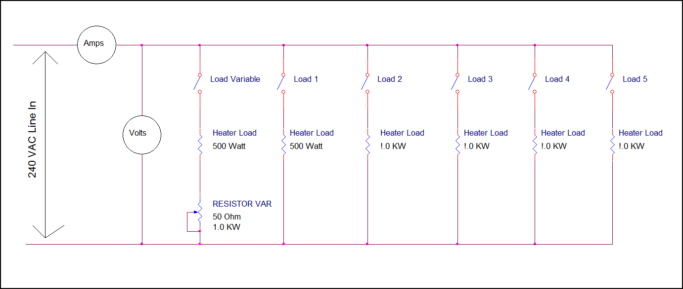

Also, I'm not sure how I'd connect the pot (say a 3Ohm pot like you suggested). I'm assuming I'd connect the elements in series to act as a load bank - and connect the pot up in series with the 5th element (the one connected to ground at one end). But if the pot goes in before the 5th element, I'm short circuiting the element, and if the pot goes in after the element, I'm either short circuiting the pot itself or simply adding its resistance to the series chain (the two extremes of the pot configurations).
I've only used pots to control voltage before, so how can I use it to control load?

(and I can use a potentiometer in series to control the load more precisely)
Just be careful about the amount of power dissipated in the potentiometer. I would use a high power rheostat in series since the lower its resistance, the more power is being dissipated over a smaller portion of the winding.
You would want to configure things similar to the attached drawing. As Gary B points out you want a heater load in series with the potentiometer. Remember also the pot needs to have a very high wattage rating. Placing a smaller load heater in series with the pot will protect the pot and allow you to trim the load a little. If we have 1000 watt elements running on 240 VAC the load current would be about 1000 / 240 = 4.17 amps so you want switching that can easily handle a 10 amp load to allow a nice margin in there. Also, you will find pots rated for 1 KW are expensive, as in very expensive. Ohmite makes a 50 ohm and 100 ohm pot rated at 1 KW. Make sure the pot will handle the current and then some.
Make sure you use wire with a gauge to easily handle the current also. Here in the US I would likely use AWG 10 or larger which open air will handle 30 amps.
In reality you could likely use a lower rated pot but then make sure other loads are switched in before using or switching in the variable load.
Hope that helps a little...
Ron

Okay I thought I'd connect the elements in series and have switches to allow the generators +v to connect in at the appropriate point. I suppose the parallel configuration would be better as the current would be divided between each branch.

Yes, in a load bank you would set things up pretty much like the diagram I provided. You place loads in parallel and switch them into the circuit as shown. Loads like this are purely resistive in nature.

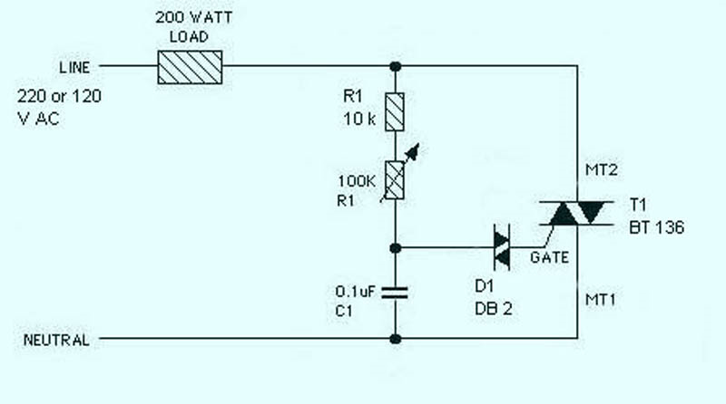

Here is another possibility for you, Allied Electronics has a triac that is good for 40 amps for $11.40 US. https://www.alliedelec.com/search/productdetail.aspx?SKU=2480310, Then go to your local stove repair place and get some used oven elements and hook them up to the triac and vary your load using a simple pot. You'll also need a really good heat sink.
Here's the spec sheet https://www.electro-tech-online.com...ECTRONICS_ACTIVES-AND-PASSIVES_2480310PDF.pdf
Using a triac would only require about 50ma of current to control the triac.
Attached is a schematic for a triac circuit, you just need to scale up for the 40 amp triac.
The fans you would need if use heater elements would just be the regular oscillating desk fan, just something to keep the air moving.
