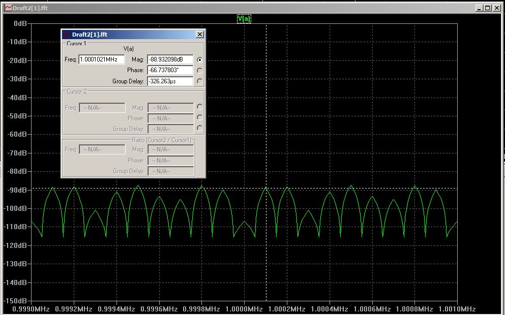

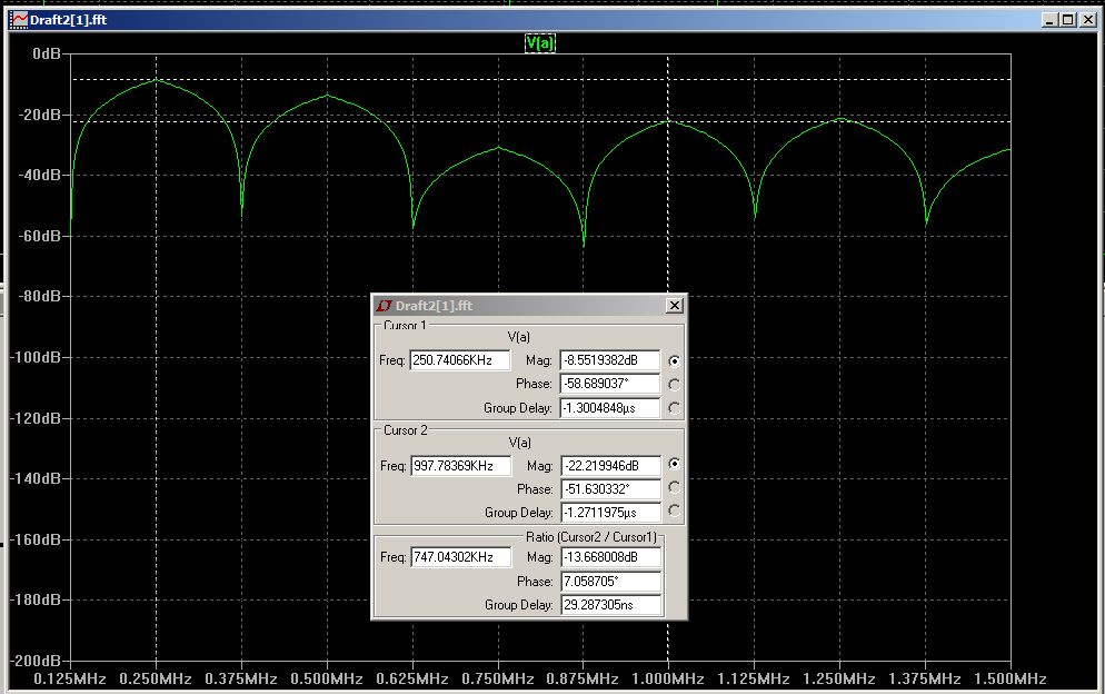

No. Here are the spectra (in the vicinity of 1000KHz, in the center of the AM Broadcast Band) of two waveforms: one is 1Vpp, 100Hz, 30% duty cycle, 50ns rise and fall times (like the AVR), the other is 1Vpp, 250kHz, 30% duty cycle, 50ns rise and fall times (like the typical Buck converter).

Note that the if you had the AM receiver tuned to ~1000KHz, the forth harmonic of the 250KHz switching rate is only about --22db, while the ten-thousandth harmonic of 100Hz is about -89db, for a -67db difference.
The math and practical experience says that it is much easier to live with the AVR than it would be to live the Buck converter, doing nothing but installing the RFI bypass cap on the alternator.
Putting it another way, by the time you do enough shielding and filtering on the Buck converter for an AM receiver to be able to coexist with it, you will have spent 10X time and money on the project as compared to just going with the LM7805...

I must say that your graphs are fairly conclusive, but something worries me. It is my understanding, like I said, that it is the edge that counts. Without going into the maths, if you put a square wave signal, of any PRF, with a fixed rise time into a scope with a fixed bandwidth the edge will be equally degraded indicating that the frequency spectrum, in absolute value rather than relative to the fundamental frequency of the square wave, has the same hf content.

I have just done a bit of revision and, yes you are right. With a perfect square wave as an example, the amplitude of the even harmonics is zero and the formula for odd harmonics is:
where:
  • An = the amplitude of the nth harmonic
  • pi = the constant, 3.14159...
  • n = the harmonic number (only odd)
spec
The reason I used 30% duty cycle is to avoid the even harmonics issue :D
The energy in the nth harmonic is inversely proportional to n, so it stands to reason that the ten-thousandth harmonic would be way down compared to the fourth harmonic, the rise/fall times being equal... ;)
