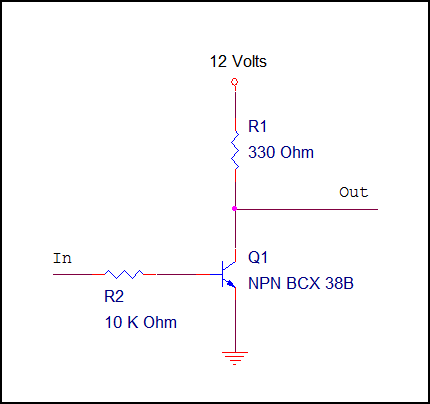

I have a device that has a 5 vdc square wave pulsed output that I need to step up to a 12 vdc output that retains the original pulse frequency. Current requirement is very low. Can someone post a circuit to accomplish this or offer some suggestions to get me started? I have CircuitMaker and have been experimenting with some circuits but I'm not having much luck.

All you should need is something like the attached. Actually any NPN switching transistor or logic level MOSFET would work. As long as the frequency is within the the transistors range. You may need to lower R2's value.

Thank you. That's pretty much what I've been experimenting with. One issue I may have with this circuit is that when the 5v input is high the output is low and vice versa. The issue I was having with using an op amp is that it never went down to 0v when the input was off, it stayed at around 800-900 mV.
Thoughts?
I'm kind of surprised at Reload-Ron, since he gave you an inverting amplifier. You could turn it into a non-inverting one by making it an emitter follower (take the output from the emitter rather than the collector), which give an in-phase output.

The OP wants an output higher than the input.
An emitter follower requires VDD + 0.6V to put out VDD. If the collector voltage is +12V and the base voltage is +5V the output voltage is about +3.5V.

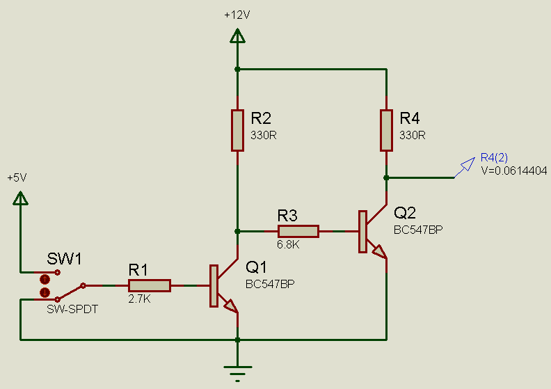

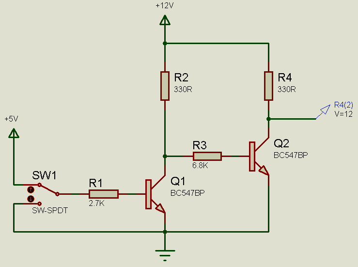

Better use two inverters in case the output signal must have the same phase as the input signal.
Take a look. It works.

Thanks guys. Looks like this should work, I'll get it on the breadboard and see how it does. I've looked at Mouser and Digikey and don't see a "BC547BP" exactly. I found the BC547B and other variants but not that specific #. Do I need to find the "..BP" type or will the others work fine?

So to summarize, what the O.P. needs is a simple noninverting amplifier with a gain of 2.4, correct? (5V--> 12V) and a bandwidth of 50kHz..
How can this be implemented with two transistors? Anyone care to show us? (Unfortunately, my electronic circuit design skills are not quite up to the task, which is why I ask, for my benefit as well.)
Any BC547 will work just fine. They have slightly different parameters, but for the purposes of your circuit they'll behave almost identically.
