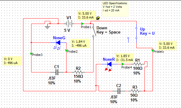

If you can check my circuit and give me any tip of advise so I can improve it. I want to charge a capacitor for the red led but I dont want to turn on the led while charging. I only wanted to be able to discharge the capacitor through the led using the up switch.

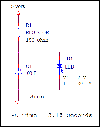

That won't work. First I see C1 and C2 as .03 Farad? That would be a 30,000 uF capacitor. The RC time constant would be about 4.5 seconds to charge the cap to 63% of V supply or about .63 * 5 = 3.15 Volts. So what happens after one RC time constant? The capacitor continues to charge. Matter of fact after five RC time constants (about 22.5 Seconds) your capacitor will charge to V supply or in this case 5 volts. That same 5 volts will be across the LED. This won't matter because after just one RC time constant your LED is dead. It will be out of its misery. :)
See the attached circuit. It is about what you have.
As to your RC time you will be hard pressed to find a 30,000 uF capacitor. Well in a small package anyway.
Read this link to better understand RC time constants and what happens as a cap charges. Note the curves as to voltage and current.
You want to maintain a current limiting resistance in series with your LED. The downside of all of this is that the LED will start with a dim glow and eventually reach full intensity.
Ron

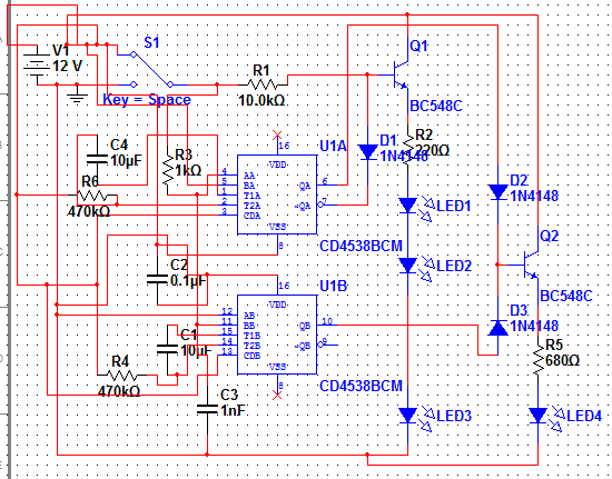

Also check what I found Gear up/down indicator That's exactly what I want but I would like to have 3 red led instead of only 1. I hope you can check the circuit and help me understand it because I have no idea how to read it and where to begin ;)

This is powered from 12VDC and should work. You can wire up the three red LEDs just like the green ones.
