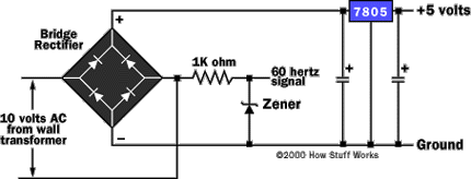

Hi there. I'm an electronics novice that decided to build a digital clock as a good starter project. I got the concept from this site: HowStuffWorks "How Digital Clocks Work" and ordered a bunch of stuff to get it going. Of course, I realize that modern clocks aren't jammed full of a bunch of decade counters, but that's not the point of the project.
The concept is simple enough...using a 10VAC/1.2A power supply, I could take the 60hz wave of the AC and divide it down twice with decade counters (one dividing by 10 and another by 6). Voila, a 1 Hz pulse to feed into a 74LS90 IC as a second counter. To do this, though, I need to get a 60Hz pulse into the first decade counter. From the diagram (attached), it should be done simply with a resistor and a 5.1v zener diode. So, I finish out the basic circuit consisting of the 5VDC power supply and decade counters. The 60hz pulse, though, isn't working. It seems like this should be the easiest part, but alas, it has me stumped.
From the attached diagram, I have 10VAC connected to a 1K resistor. The other side of the resistor is then connected to the zener and the input on the decade counter. The other side of the zener is connected to the 5VDC ground. I have LEDs connected to the outputs of the second decade counter so that I can see it output binary 0 to 9. It just turns on a single LED and doesn't count, though.
From the look of things, I think that the pulse just isn't there. I have tried three different zeners, but no luck. I don't have an oscilloscope to veify the pulse, but my multimeter tells me that the expected 5.1VDC is coming from the zener.

I also forgot to attach the diagram for the pulse and 5vdc power supply I'm using. Here it is!

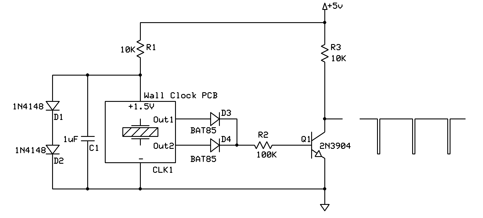

Since nathanoyler appears to be looking for a 1Hz signal in the end, gut a battery desk/wall clock. They have two 0.5Hz, 1.5V outputs across the drive coil, 180 degrees out of phase, that can be added to make a 1Hz pulse generator. As for accuracy, the only time I have to reset them is after changing the battery or Daylight Savings Time.
Ken
Make this simple change, use a 1N4001 or equivalent diode.
Eric,
Isn't the output pulse rate across the +/- terminals of a bridge rectifier 120Hz (100Hz UK). I think in the original circuit the lower right diode "shorts out" the resistor/Zener on one half cycle, so you only see every other pulse.
Ken
Eric,
Ken
hi Ken,
I thought the OP was going to use a div by2 on his original circuit.??
I would use a 7492 for 60Hz [at 120pps] to give the 'tenths' decade.
In the UK we would use a 7490 for the 'tenths'
He is reporting that the original cct isnt working at all.?
